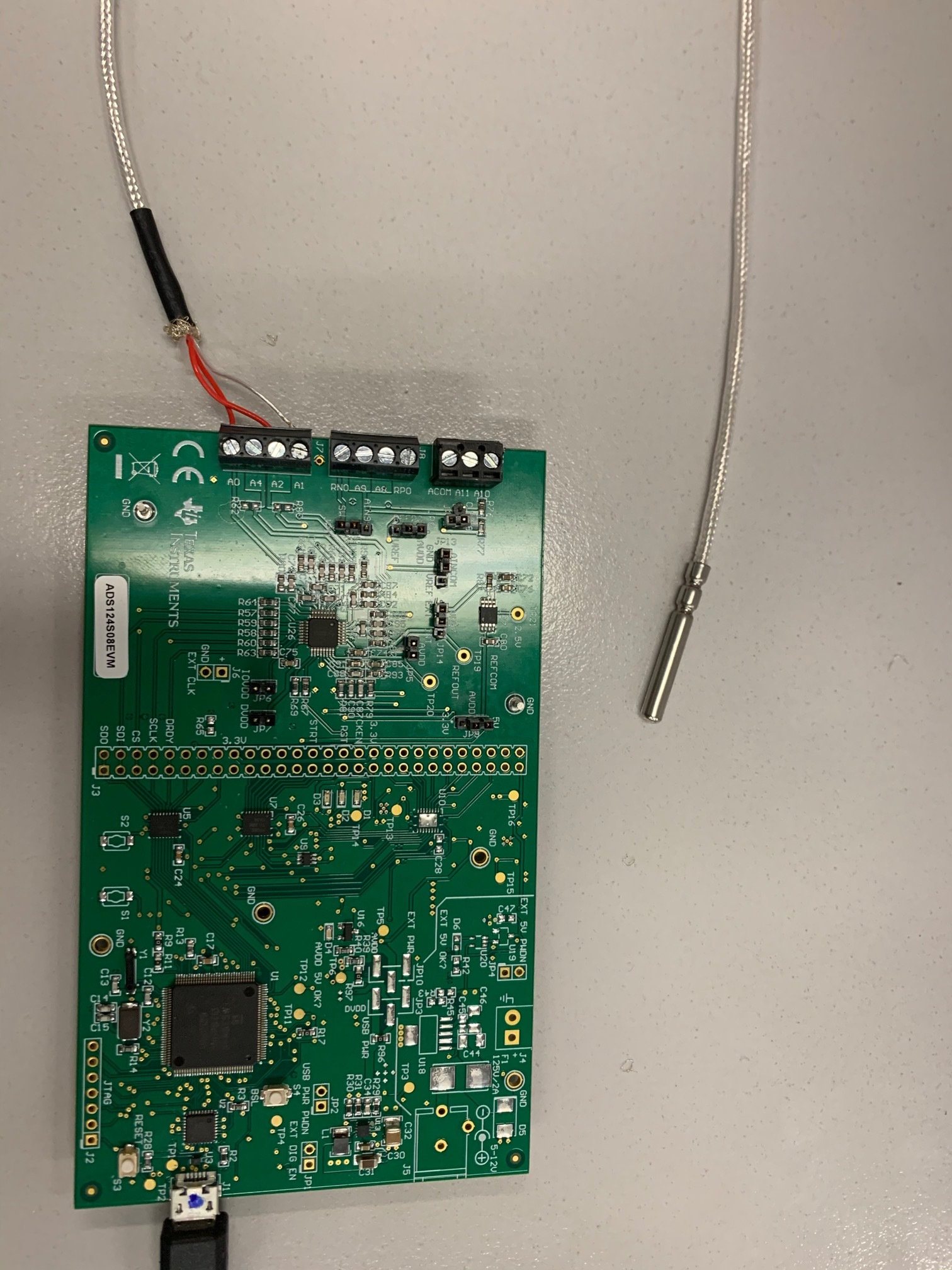

  • Hi Bob,
    Really thank you for your help! It's really helpful for me.
    Today, I used the ADS124S08 EVM to test the RTD. And I got other questions that need your help.
    1. I configured the EVM according to the picture below. And I got the result as attached and I changed the VRef to be 1mA*1kohm=1V.
    According to the result, RRTD = (2 × R68 × ResultCODES / PGA ) / (2^24 – 1)=2*1kohm*3695881.5/4/(2^24-1)=110.14ohm. Are these analysis above correct?
    Besides, according to the test result, how can I calculate the TUE and noise? Since the result curve is appropriately straight down and I can't figure out where the highest density is.
    2. According to the EVM schematics, the EVM can only be used to test Three-Wire RTD Measurement, High-Side Reference. If I want to test
    Three-wire PT100 RTD measurement circuit with low-side reference and two IDAC current sources, I need to draw another board like the picture below. Am I correct?
    Thank you so much for your help!
    Wendy
  • Hi Wendy,
    You are correct in that the ADS124S08 is designed to make a high-side reference measurement for RTDs.  To maximize the various different sensor inputs, we used the high-side reference to demonstrate the use of this method.  If you want to make the measurement low-side you would have to create a new circuit path as you have mentioned in question 2.
    In response to question 1, yes your calculations are correct and for the time domain plot you would use the reference voltage at 1V.  However, for the RTD resistance calculation you would use codes regardless of the reference voltage as the measurement is ratiometric.  So in the time domain plot drop down option could could select codes.
    As to the variation you are seeing, you most likely are using the default of 20sps data output rate which takes approximately 102 seconds to complete.  So what you are actually measuring is the temperature drift of the RTD response.  So how would you determine the error of the conversion in this case?  You really cannot unless you stabilize the RTD temperature to a constant value such as in a temperature bath.  For now I would suggest limiting the number of samples to 128 and in this way it may be a little easier to detect the noise.
    So when you speak of TUE are you specifically concerned about the TUE of the ADC or of the system?  For determining the error we would normally use a precision resistor of fixed value as the sensor to be excited.  The resistor is a high quality resistor such as a Vishay Y6071100R000T9L.  This removes any error of the RTD and limits the temperature effects to that of the limits of the precision of the resistor.  Customers sometimes use an RTD calibrator which will introduce some error but the output will be stable as compared to an an actual RTD.
    When determining the total error, the reference precision and stability directly affect the ADC result as well.  The resistor used on the EVM is not highly precise (1k +/- 0.1% with 25ppm per deg C temperature coefficient).  The reference resistor will add some error relative to potential gain error.  Replacing the resistor with a higher precision will improve the TUE.  Also, by using a second fixed resistor of a different value for the RTD input will help to determine the offset/gain error of the system.
