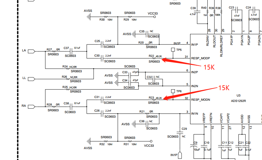

Our customer is using ADS1292R to measure impedance. But he can NOT measure 0.2 Ohm impedance. Could you please help review the schematic as attachment and give some suggestions about this issue?
Thanks.

Hi Kevin,
Can you provide more information on your test setup and the test results you are seeing? You can reach out to us at ads129x-support@list.ti.com with more detailed information and the full schematic for us to further look into the issue.

Hi Kevin,
Thanks for the additional schematic information that you provided. It will also be beneficial for us to understand what are all the parameters you are using to test the Respiration circuitry such as the device register setting, baseline body impedance, cable used, and etc.

Hi Kevin,
It is difficult to review the partial schematic from the previous post. If possible, you can email the complete schematic to the ADS129x AFE support email list for the team to review it.
