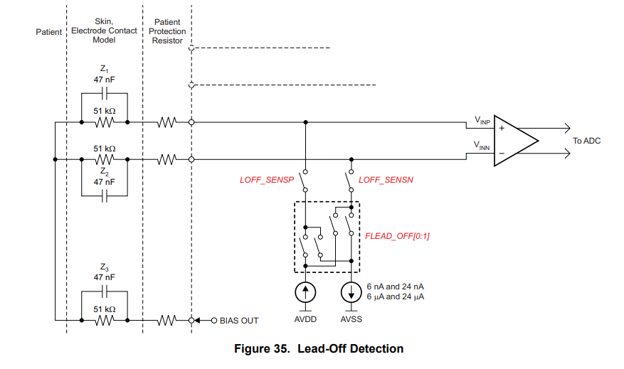

Our customer is trying to measure the resistance value between IN7P and IN7N using the Lead off Detection function of ADS1299 with the following settings.
1. A resistor is inserted between the IN7P pin and IN7N pin to make it short-circuited.
2. Set the register as follows
- ILEAD_OFF: 24uA
- CH7SET: 0x60
- (Set with PD7: Normal Operation, GAIN7: 24, SRB2: Open, MUX7: Normal)
- LOFF_SENSP: IN7P only Set with Enable (0x40)
- LOFF_SENSN: IN7N only Set with Enable (0x40)
- MISC1: SRB1 set with Switches open
Can you give me some advice as to whether it can work with the above settings?
