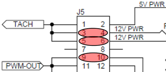

  • Hello Michael,
    I'm sorry for the delay, but I'm glad you were able to read and control the PWM signal.
    As for the PWM signal, I cannot think of anything else besides the jumpers in J5.
    Previously, you mentioned that you were reading the signal from J5 pin 9. This tells me that the third jumper in J5 is connecting pins 11 and 12 instead of pins 9 and 10.
    With pins 11 and 12 connected, the PWM signal is send to a MOSFET that is used to control 3-wire fans. Since you are using 4-wire fans, the third jumper should connect pins 9 and 10 as follows:

  • Rafael - The J5 11-12 jumper was the problem, and moving it to 9-10 solved it for me.  Thank you very much.
    Part of the problem is that the jumper settings for J5 9-10 and J5 11-12 are not very clear in the documentation.  Looking back in the document "SLAU195A–December 2006–Revised February 2009", Figure 9 on page 13 shows the same J5 jumper setting for both 3-wire and 4-wire fans.  I suspect this is an error with the document.  Can you look at it and confirm?

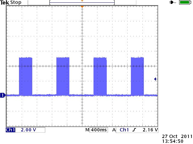

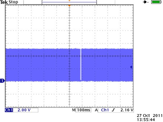

    1. About my own design, The pwm-out is not continuous with the tach-mode cleared; (so I tried to go back to the evaluation board, but)
    2. About my evaluation board, the high level of pwm-out is 200mv and the after I write 0x01 to CR1  the pwm output become not continuous either;

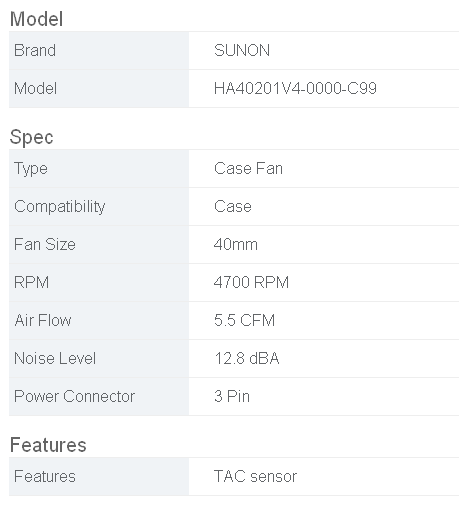

    About the fan, I am using
    SUNON HA40201V4-0000-C99.
    I am sorry I dont have the complete datasheet at hand. Maybe you know it. Or I will forward to you later.

    The non-continuous PWM is due to bad TACH readings keeping the AMC6821 looping. This is explained in page 26 of the datasheet.

    The following diagram shows how to setup the evaluation board for 12V 3-wire fans.
    The six jumpers for 12V 3-wire fans:
    W1:1-2
    W5:3-2
    W8:1-2
    J5:3-4
    J5:5-6
    J5:11-12

    The maximum speed for the SUNON fan is 4700RPM+/-15%, so 75% of this speed or 3525RPM should be easy to get.
    I got the non-continuous PWM when AMC6821 worked on the Software DCY control mode. If it worked on Software RPM control mode on my design, the speed will either increase to the max speed or decrease to stop gradually. So I tried the software DCY mode first to see if the PWM stable. It is the garantee for a stable tach signal. Then I get all the scope pictures. At DCY mode, TACH feedback can still keep it looping?
    Both of the above pictures happened at the DCY mode, when there is no fan connected (no TACH feed back). When there is a fan connected. the gap becomes very narrow but at the same frequency. So I can see spikes after the transistor. If I read the tach signal from TACH_DATA (CR1=0x01,CR2=0x05), the value also jumps among very different values. Only when the tach_mode is set, the PWM can be continuous at DCY mode.

    When TACH-MODE is ‘0’, non-continuous PWM is to be expected because the PWM is forced “ON” during a TACH measurement.
    When using a 3-wire, TACH-mode must be ‘0’ because TACH measurement should be done when the PWM is forced ON. The gaps you see are used to measure TACH. These gaps should be high instead of low. This is because PWMINV is ‘0’. PWMINV should be ‘1’.

    Regarding the three 10K resistors for the fan’s TACH output, should I use 4.7K as on the evaluation board instead of the 3rd one to lower the voltage to the TACH In pin?
    A 4.7K resistor produces a TACH signal at the AMC6821 TACH pin that swings from 0 to 2.3V with a 12V supply. Since you are using 5V VDD, I thought it would be better to increase the size of this resistor to have a TACH signal that swings from 0 to 4V.
    Regarding the transistor's rate, there are one resistor and the fan in series, so 20V is OK?
    The drain-to-source voltage is maximized when the transistor is OFF because it becomes a big resistor. Also, the resistor in series is insignificant when transistor is OFF. In OFF state, the FAN brings the drain voltage down to 0V, and the drain-to-source voltage becomes 24V. Your transistor might be working now, but I’m sure it will break down eventually.
    Regarding the gaps used to measure the TACH, I still have doubt. Even if they are high instead of low, would they also influence the stable fan speed?
    I understand you concern, but I haven’t seen significant speed changes using low frequencies (PWM-MODE = ‘VDD’).
    As you noticed, the 100% duty cycle gaps are long when the fan isn’t connected. This is because the AMC6821 is waiting for TACH pulses. If the fan TACH is connected, the TACH pulses are detected fast and the gap duration is very short.
    TACH sensors in 4-wire fans don’t need the gaps because their TACH sensors are always ON, but this isn’t the case for 3-wire fans
    3-wire fans TACH sensors turns ON and OFF with the FAN. Thus, 100% duty cycle gaps are required to make sure the TACH sensor is ON when reading TACH pulses.
    Also, a fake TACH pulse is produced during a PWM cycle, and this is avoided while reading in the 100% duty cycle gaps.
    In other words, 100% duty cycle gaps make sure that the TACH sensor is powered to get good readings and avoid fake signals. Please use TACH-MODE = ‘0’ with your fan. Also, use PWM-MODE = ‘VDD’ and PWMINV = ‘1’

    Regarding the demo board, I have a comment on the inversion gate, which can be bypassed by the pin 11/12 of J5. You also suggested to use the jumper for it. But if I bypass the logic gate, a very big noise will come to the system, everywhere even for the power. Then the board doesnt work at all. I dont know what has happened on your board. But I guess bypassing the logic  gate will make a loop (feedback). It seems not good. So I dont bypass the inversion and keep PWMINV=0(logically the same). Then it works at this way.
    I will try my own design later. I hope I will have some more good news.
    Lei
  • Hi Lei,
    It is great news that you got it to work!
    Regarding the 30% limit, yes you are right. If you want to stop the fan, you need to change, for example, to DCY mode and change the duty cycle to 0%.
    Thank you for pointing out the logic inverter. Previous revisions of the AMC6821EVM don’t have R10 and R16 installed, so it was required to use a jumper at pins 11 and 12 to send the signal to the NMOS transistor. My board doesn’t have those resistors, so I needed to use a jumper and PWMINV=1. Since your board is a new revision with those resistors installed, you setup is perfectly fine without a jumper in pins 11 and 12 and PWMINV=0. I’m sorry I didn’t notice that before.

  • Hi Rafael,
    I think it is better for you to change the user manual. Or it will not work with the jumper on pins 11 and 12.

    Regarding pins 11 and 12, I will make sure the manual is updated as soon as possible.

    As I understand, the AMC6821 measures the rotations during the monitoring time when using TACH-MODE=0, so it should measure the rotations only when Q4 is ON as long as the PWMINV bit is the right value.
    The fan’s TACH output is an open collector, but sometimes the fan manufacturers don’t isolate this output completely. This could mean that there is other internal circuitry connected to this pin.
    In the case of the SUNON fan, its datasheet mentioned that the pull-up voltage for the TACH out is the “FAN Vcc,” so I assumed the SUNON fan doesn’t have a completely isolated TACH output.
    Without a completely isolated TACH output and a pull-up to VDD(5V), current from VDD might go inside the fan circuits when Q4 is OFF and affect/damage the TACH sensor.
    Also, the voltage at TACH output might need a pull-up to the fan operational voltage to work fine, but since you have the TACH output working fine with a 5V (VDD) pull-up, I don’t think this is the case.
    You could try running the fan with a PWM signal overnight using a pull-up to VDD and see if the TACH signal gets noisier. If it doesn’t, it might mean that the TACH sensor is not affected by the VDD pull-up.
