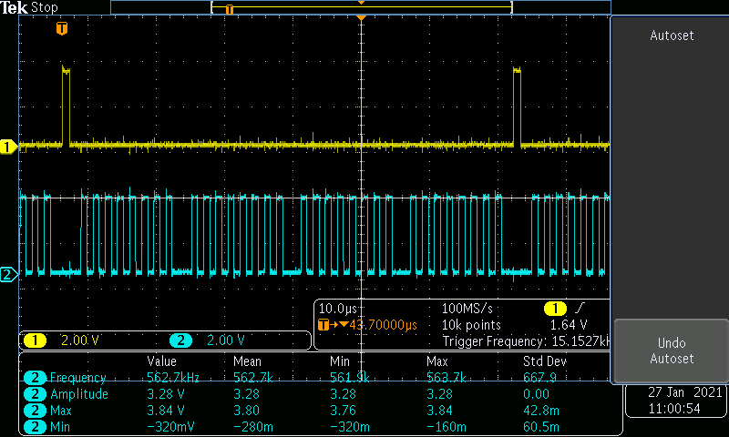

    For the reference voltage, I am only using internal reference +2.5V & -2.5V. Since I am not getting the output i m trying all other combinations,
    My DRDY pin is not getting low at all yet I am able to read values in DOUT pin yet not the correct value
    First image RDATA output; yellow line - output, BLue line - clock;
    second Image yellow line -output, BLUE line DRDY
  • Hi Sasi,
    The data read transaction in the first image actually looks correct: 0xFF 12 00 AA 00 00 00 2B, where 0xAA is equal to CRC-2 of 0x12 00, and 2B is equal to CRC-3 of 0x00 00 00. This implies that you are not reading the STATUS byte, is that correct?

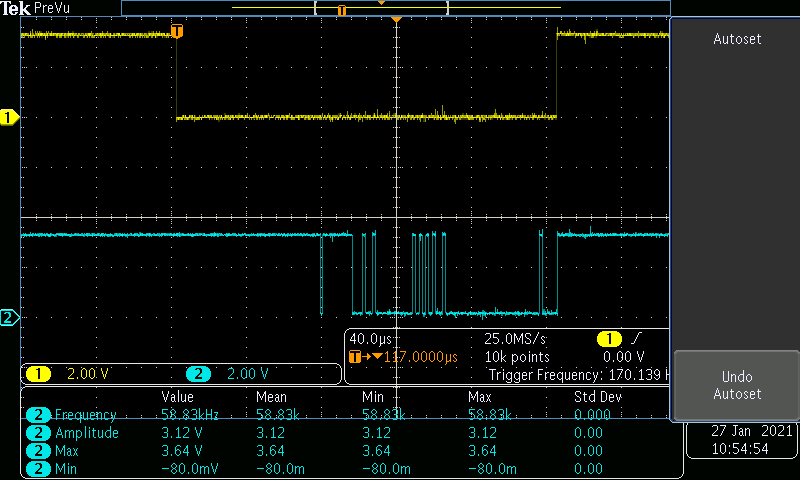

  • Hi Bryan,
    I am using continuous conversion mode.
    IF I use START PIN to start my conversion random values are produced, the Yellow line is DRDY, and the BLUE line is DOUT, here the time duration also varies for outputs, since the time stamp provided is 40us for both.
    Now I am using the start command for starting the conversion, START pin is grounded,
    First image yellow line -cs, blue line clock
    Second Image blue line - clock,  yellow line DI
    third image - yellow line - DI, blue line - Dout
    without providing start command or 3.3V to the start PIN when I read the RDATA register I am getting the same output,

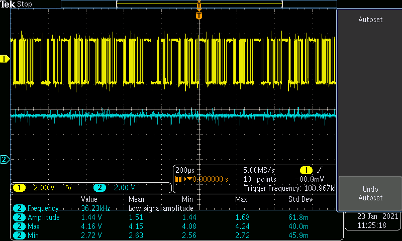

    I have set the default data rate of 20SPS, I have attached the images for 1s response where my DRDY line gets low more than 20 times , and even if the DRDY is high the DOUT provides the same output
  • Hi Sasi,
    Do you have a logic analyzer? It would make this much easier if I could see CS, DRDY, DIN, and DOUT all at the same time.
    I am not really sure what the signals are in the last three images you sent either, since they are not labeled. Is that DRDY and DOUT? If so, the second image shows DRDY going low multiple times in a row. To operate the ADC effectively, you should send the RDATA command as soon as DRDY goes low in order to make sure that you clock out data fast enough. Multiple pulses in a row suggest that you missed a conversion. Are you using the dedicated DRDY pin to identify when new data is ready?

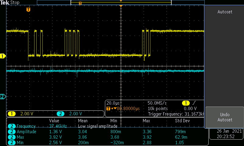

    i cannot figure it out what is my issue, My DRDY pin gets low but the data i read is 0x00,0x00,0x00 only yet when i check it with CRO i get various data
    yellow line - DRDY, Blue Line -MISO
    DRDY gets only only when i start conversion by providing VCC in start PIN, when I provide GND to start pin and execute start command my DRDY pin does not go low, yet MISO pin receive some data

    Why is there output on DOUT all the time, even when DRDY is high? Are you requesting data all the time? Is there activity on DIN at this point?
    If you are not sending commands to the device then something is wrong with the communication here, as you should only see data on DOUT once per data read. Please help me understand what is happening here.
    I will reiterate that this is where a logic analyzer would be very useful, so you can see all of the communication signals at the same time.
