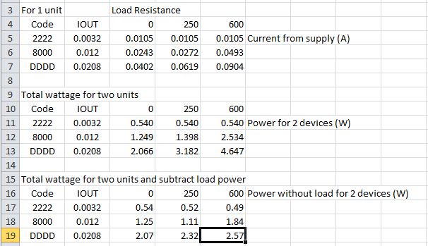

My customer will use 2pcs DAC8775 for their product. So the product has 8ch 4-20mA output.
They would like to operate with full tracking mode to minimize power dissipation at device.
As a result of evaluation, about 3W(8ch total) power dissipation was observed under condition that PVDD=26.4V, Iout=20.8mA, Rload =600ohm.

  • The customer summarized 2pcs DAC8775 power dissipation at each Iout/Rload condition in "Power Dissipation Calculation" sheet.
    Would it be possible to check if these power dissipation is reasonable or not?

    I've used a DAC8775 to set up the same test. I get less of a current consumption than your customer gets. From my measurements, I get values that are about 0.4W lower than the customer across the range. For my measurement, I get about 2.57W for high IOUT=20.8mA, Rload=600Ω.
    Note that my supply is a little lower than your customers. I used a supply of 25.7V which is the maximum for my supply, instead of the customer's supply of 26.4V. This shouldn't be much of a change because the buck boost should have a very similar power dissipation.
    The calculation looks like this:
    And I've attached the excel spreadsheet to the post as well.
    1401.Book1.xlsx

    It seems that the customer's setting works properly with full tracking mode but efficiency is not as good as your evaluation.
    I will suggest to use 12V PVDD to maximize efficiency of internal buck-boost.
