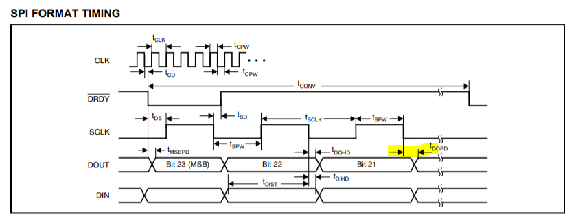

    We were able to dig up some data for the ADS1274 measuring noise verses IOVDD, with IOVDD adjusted from 1.65V to 3.6V.  There is a very small change in noise as IOVDD is adjusted, but on the order of a few percent, not 1000x.
    The only other parameter that I can think would change are the timing delays which typically increase at lower voltages.  Could you provide a timing diagram for the SPI?  DOUT, SCLK, and CLK?
    Also, I read through the information you provided again.  Is there a possibility that the CLK, or other IO lines are driven before IOVDD is settled?  If so, this could cause the device to not operate properly.  After power-up, please assert the /SYNC pin, which will have the effect of resetting the device.  If there are any issues during power-up, this should fix it.

  • Hi Robert,
    Let's check the timing between the SCLK falling launch edge and DOUT, t-DOPD.  Decreasing the IOVDD voltage increases the maximum propagation delay time from 26nS to 32nS.  You may be missing the correct data in this case.  If your MCU is capturing data on the rising edge of SCLK, in order to meet the t-DOPD value of 32nS, your maximum SCLK frequency should be no more than about 12.5MHz.
    What is the frequency of CLK and SCLK?  If there is a timing issue, try slowing SCLK down by 50% (assuming you can still clock all 24b data within the data rate period).
    Keith

    The SPI controller is sampling on the rising edge and the oscilloscope shows this to be in the middle of the data valid region as expected at this speed.
    I have put a DC input to the buffers to bias them to mid-range (near 0 on the A/D output) and looked at the data on the oscilloscope to confirm the SPI data. The first 11 bits are constant (0000 0011 100 in the latest test) with the next 13 bits noisy. This is similar to the noise the controller is reading.
