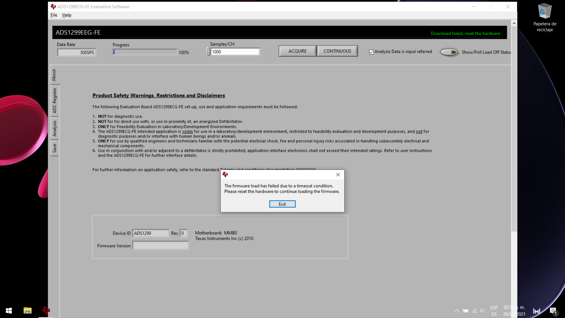

ADS1299EEGFE-PDK: The firmware load has failed due to a timeout condition. Please reset the hardware to continue loading the firmware.
Genius 9880 points
Part Number: ADS1299EEGFE-PDK
Hi Team,
Customer encountering error that FW has failed due to timeout condition.
Customer already downloaded the new versions and reintegrated the software but it still does not work as stated in the workaround found in this link: however they still encountering the error.

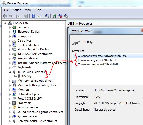

    It seems like there is some issue with the USBStyx driver during the installation process. When you start the ADS1299ECG-PDK software, you should see the EVM re-enumerate as a USBStyx device. I have posted the picture from the original post here for your reference.
    Please uninstall the software completely and try to reinstall the software with the Administrator right. Please make sure you follow the step 3.3.1 in the user's guide (page 12) to install the USBStyx driver.

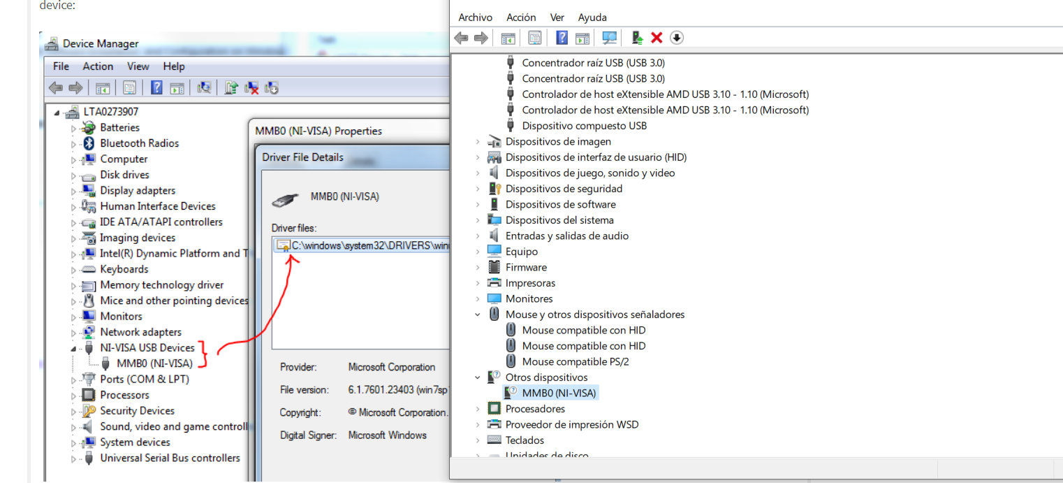

    I followed each one of the steps in the installation of the Software and Drivers, with all the administrator rights, the device appears as "NMBO (NI-VISA)" before starting the software, after starting the software the card is renamed as "USBStyx", (I attach the screenshots)
    However, when I connect the card the software takes more than 10 minutes to "read records" then I click on "Acquire" and that is when the error message is displayed.

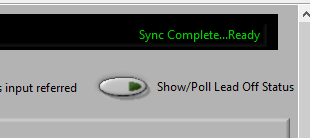

    Please see below for a few things to check after the EVM is connected and the GUI software starts.
    1. When you start the GUI software, are you able to see the "Sync Complete...Ready" on the right side of the title bar? See the attached image of what the status message looks like when the EVM is connected and ready. Please also check if the device registers read and write operation is functional.
