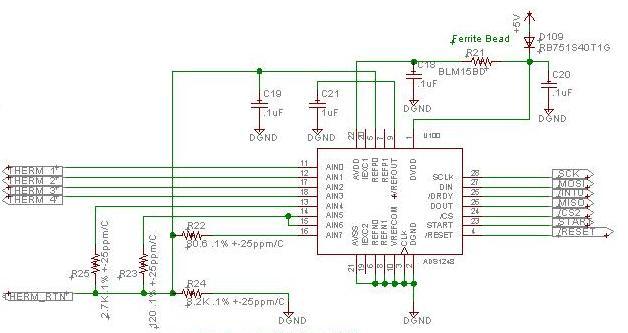

We're using the ADS1248 in a temperature measurement circuit. I've included a snippet of the schematic at bottom of this post.
The out microcontroller periodically connects the IDAC1 to AIN0 - AIN3. IDAC2 is normally connected to AIN7. The temperature sensors can be connected between THERM1 - THERM4 and the common node THERM_RTN (see our schematic below). We've found that if we ever switch the multiplexor with IDAC1 and IDAC2 on (100uA) to an open circuit, then subsequent measurements will be inaccurate for a significant amount of time (at least 28ms).  In order to avoid this problem we're changing microcontroller firmware to periodically (slower period then normal sensor measurements) check for a  open-circuit sensor channel. When this is detected we avoid connecting the IDAC1 and IDAC2 sources to this sensor channel during normal sensor measurement polling. We thought that the long transient affect of connecting to an open-circuit sensor may be related to the IDAC current sources. If so, we guessed we might be able to use the Burnout Detection current source pair for checking for open circuit. In this way we thought we may be able to check for open-circuits more often and fits better with our normal sensor measurement polling sequence. However, I'm unable to the get the Burnout Detection current sources to actually source any current.

  • Hi Eric,
    The current output settling of the IDAC current sources occurs in less than < 200us (typically around ~20us).  The voltage settling of the circuit will depend in the external RC constants involved.  On the schematic shown, a 8.2 kOhm resistor is connected to the REFP pin with a parallel 0.1uF bypass capacitor; forming a corner frequency around ~200Hz.  When the IDACs are connected to the open sensor; the voltage accross the 8.2kOhm reference resistor drops and needs to be charged again when is connected to the next sensor. In order to obtain a 20bit resolution measurement; the user would usually have to wait over 14 time constants for the external RC filters to settle.
