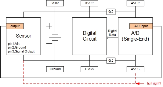

How to separate the Analog and Digital ground
I have a battery power for the sensor and system.
I use 0-ohm to separate digital and analog area.
But my sensor needs battery too, and the output is analog signal.
So, the system diagram shows in following figure.
My question is what the sensor's "Ground" is?
DVSS or AVSS?
For A/D converter, I thought the sensor ground should be connect to AVSS. (red dotted line)
Then Ground = DVSS = AVSS, all connect together..............I feel weird.........
In this case, how do I do?
