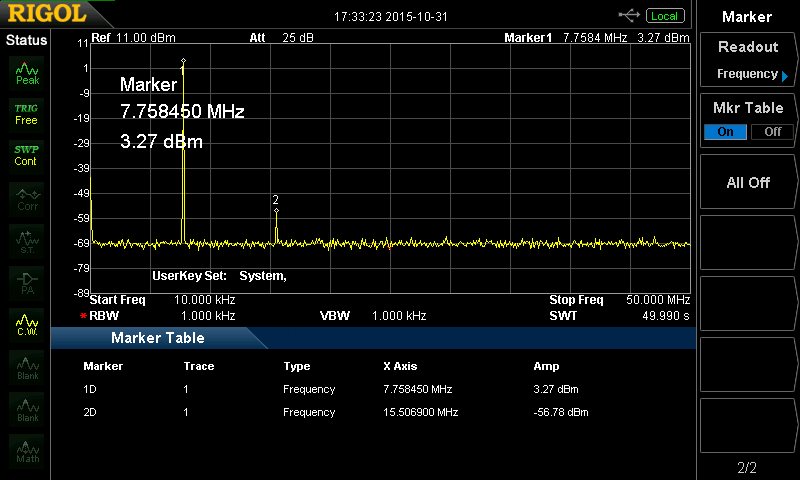

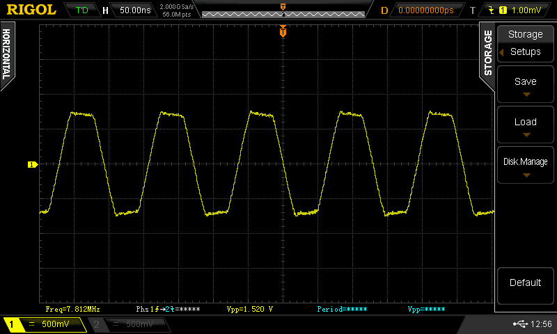

If I generate full scale sine wave using HSDC Pro I get severe clipping as on the scope picture.

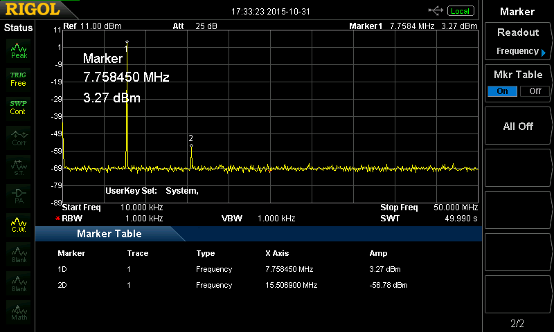

If I reduce the data (using scaling factor 0.6 in HSDC Pro) Then I get what I have measured with the spectrum analyzer.
In this case I get my sine wave in the 1.5Vpp range but first harmonic is  about -60dBc.
From the  SFDR I see this is expected to be 20 dB better.

    1> If you set the QMC gain to 1444, the QMC gain is 3dB higher rather than 0dB(default 0dB is '1024'). So if you put the full scale in HSDC Pro, then use 3dB gain in QMC block, then you will cause the digital block go to saturation. This explain why you see the distorted sine wave with many harmonics. The way to solve it is to back off digital signal in HSDC-pro just like you have done , or back off the QMC gain.

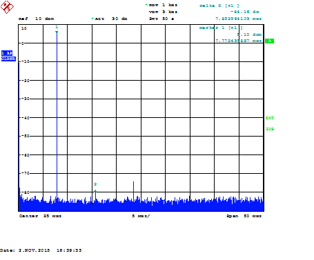

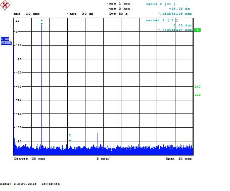

    2>I have done the same configuration and same test(with 0.6 scaling in HSDC Pro and QMC gain = '1446'). I haven’t seen HD2 degradation in my case(with R&S FSQ signal generator) as below:
    I am not so familiar with your RIGOL signal analyzer, and maybe the distortion is caused by instrument rather than DAC. Some suggestion:
     a> Try to adjust ATTEN to see whether it helps.
     b> Try to test with tone of higher frequency, and maybe instrument is not good at low frequency  when input is AC coupled.

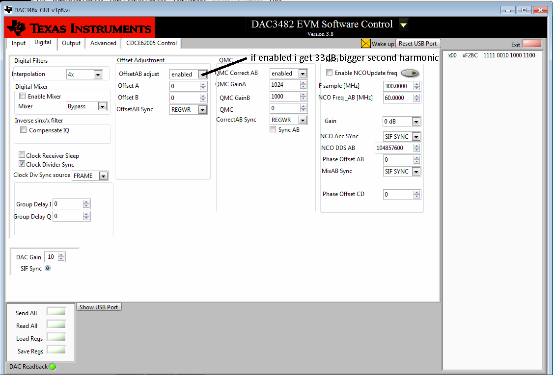

    I found something strange. Please see below picture.
    If I have QMC offset disabled I get about 33dB improvement in the second harmonic distortion I measure.
    (my second harmonics gets 33dB reduced compared with the case QMC offset block in the GUI is enabled and Offset A and B are 0)
    My believe is that Offset AB adjust enabled or disabled shoul dnot affect me as far as Offset A and B are 0.
    Any logical explanation about this behavior?
    With OffsetAB adjust disabled I have measured second harmonics -68dBc (for 80MHz tone) which probably is close to the non-linearity of my spectrum analyzer.

    2>I have enabled and disabled the QMC offset adjustment in my setup, and I haven't seen HD2 changes.
    Kindly, could you please follow my suggestion as below:
    When enable offset adjustment, re-type '0' in offset A and offset B to make sure 0 offset value is set to DAC. Then use the SIF_SYNC on the GUI.
    Also, could you kindly post your spectrum snap to me when enable and disable offset adjustment.

    I can not reproduce this observation anymore so lets assume this have never happened.
    And yes I know about register write sync feature of the DAC.
    As a general comment. I beleive that the measurement distortions I have observed are due to my measurement equipment.
    Soon I plan to verify the design with another spectrum analyzer with better dynamic range.
