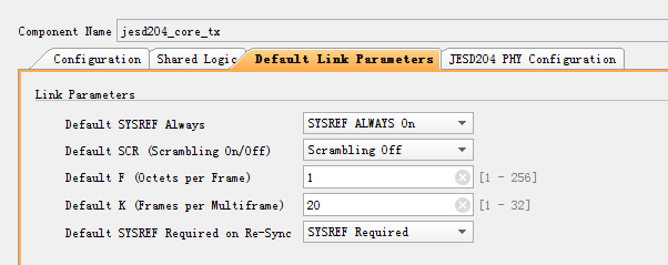

the JESD204B core of XC7V485T is as follows:

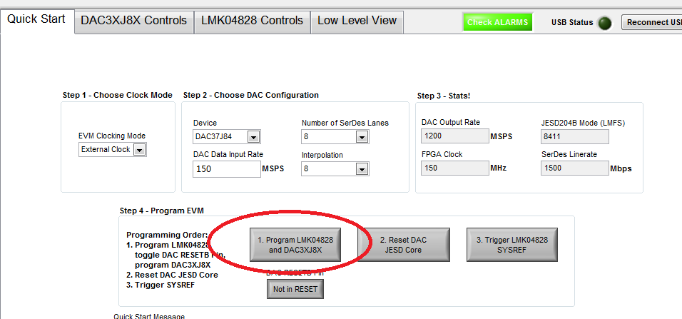

I use DAC3XJ8X GUI v1.1 software (not connect any equipment, running software alone) ;
Click the Program LMK04828 and DAC3XJ8X button, the software automatically generate related parameters;

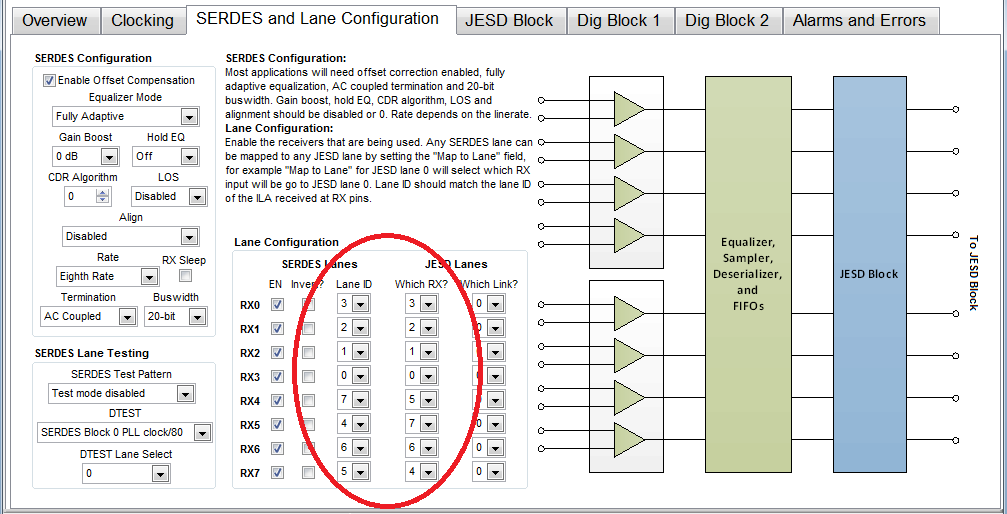

in the SERDES and Lane Configuration interface
questions 1: LaneID order is 32107465, Which RX? The order is 32105764.Here is correct?What is the correct order?

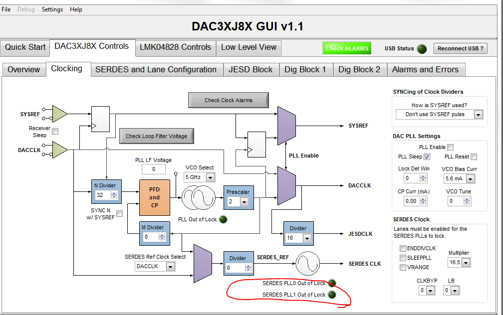

According to the 0116. DAC38J84 Start - up Sequence of the documentation process configuration (continuous SYSREF), when I read back  the SERDES PLL state(register 0x6C), the value is 0xF00F, PLL unlocked, why?

    1. The default DAC38J84 EVM interfaces with TSW14J56EVM. Due to PCB layout in FMC connector, we have connected the SERDES TX lane from the TSW14J56EVM to the SERDES RX lane on the DAC38J84 EVM with the order of lane #3, 2, 1, 0, 7, 4, 5, 6. These are the SERDES lane number, and they are mapped through our JESD204B RX crossbar/mux to JESD204B lane0, 1, 2,3, 4, 5, 6, 7. For detail, please refer to our EVM schematic and information regarding JESD204B RX input crossbar
    7.3.1.2.4 JESD204B Lane Multiplexer.docx
    2. The SERDES PLL should be locked with default quick-start configuration.
    Note that there is also a on-chip PLL/VCO circuit that provides the DAC sampling clock. You may not necessary be using it, and it is not used by default.

    In the system, sysref generated by FPGA internal logic. then output to the FPGA jesd_core and dac37j84 chip. as shown, I produced five sysref signal, frequency and LMFC is consistent. when JESD_CORE received the sysref, it start the synchronization process (BCBC character + four frames).
    after receive the sysref Dac37j84 pull the sync is low. JESD_CORE restart a synchronization process to send (BCBC character + four frames), but the sync signal is going high and low, what reason causes this? I still have no idea, you can say some more detailed?  I don't get  TSW14J10 reference code, can you send me a link?

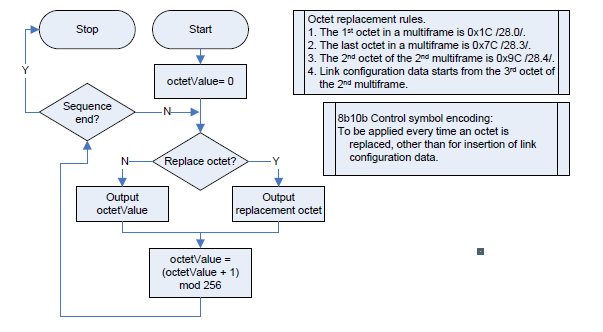

    If the LVDS SYNCB is toggling, either the CGS stage or the ILA stage is not passing. The CGS stage involves in K28.5 characters, and the ILA sequence are specific to you JESD204B settings between JESD204B TX and JESD204B RX logic (DAC)
    The DAC38J84 family has an internal build in pattern test for you to verify the CGS stage and ILA stage. See below for test procedure:
    7.3.1.2.5 JESD204B Pattern Test.docx
    See below for ILA sequence configuration check.
    DAC3xJ8x ILA Sequence.xlsx
    The ILA sequence is described by the following JESD204B standards. It consists of four multi-frame. Each octet is based on the 8bit counter value. You will need to replace certain octets as described in the octet replacement rules. For instance, the 1st octet is always 0x1C, and the last octet is always 0x7C. The 2nd multiframe is where you insert the ILA sequence consist of the JESD204B configuration information in the Excel sheet

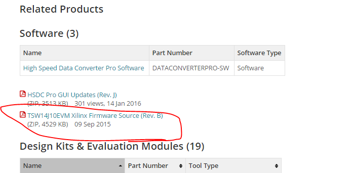

    The TSW14j10 EVM website:
    download link.

  • Hello! Kang Hsia,
    I bought a DAC38J84EVM and a TSW14J56EVM , now i am debugging my FPGA program on it. I want to ask where can i download the document you and liu talking about ? The document including these chapters such as : 7.3.1.2.4 JESD204B Lane Multiplexer and 7.3.1.2.5 JESD204B Pattern Test ...
    Thank you very much and I am waiting for your help !
    You should be able to download these documents from the link within the post itself. See the post that I on March 11th, 8:26AM and March 9th.
    -Kang
  • Hello Kang
    Thank you for your replay , I have down load these files, thanks!
