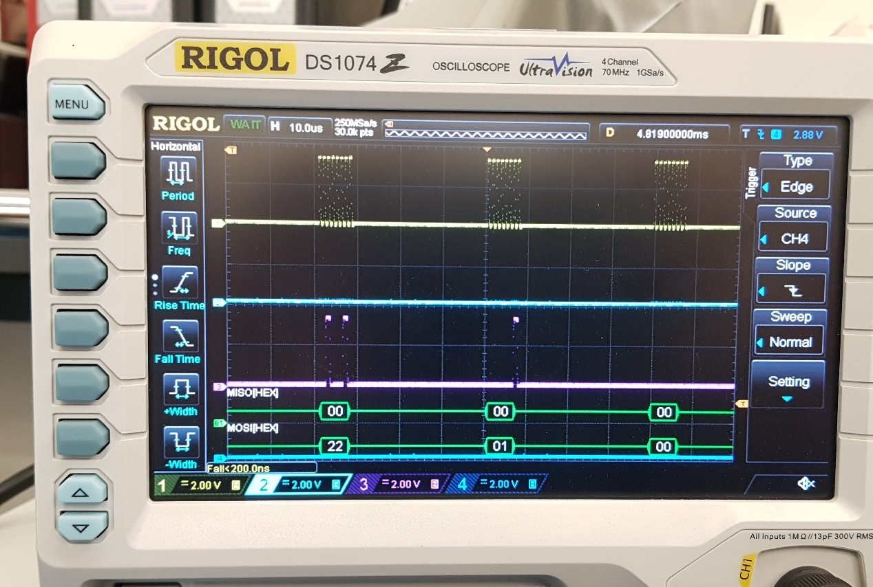

I have designed a Launchpad shield for use with 6 load cells but am having issues with getting the SPI interface to function correctly.
I am using the UCB1 SPI pins available on the Launchpad
P5.0   UCB1SIMO
P5.1   UCB1SOMI
P5.2   UCB1CLK
The following code worked well in communicating with a DS3234 RTC  but has been modified to get the correct Polarity and Phase for the ADS124S08

In my main loop I initialise all the hardware and then drop into LPM4 and use a 1 second timer to service my routines.
In the main loop code below, I have disabled the RTC code and have only the ADC chip operating on the UCB1 SPI bus to debug.

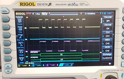

I am having issues with basic reading of the Registers in the ADC_Test() function call.
I can see the transmit data appearing on a scope (P5.0), but am not receiving any data on SOMI  P5.1
CH 1 is SCLK CH 2 is SOMI, Ch 3 is SIMO  Ch4 is CS,
This is image relates to code in ADC_Test()  where the MUX_Channel and Data_Rate registers are read.  Been battling this for a while with no success.
Hoping it's something simple I have overlooked.

  • Hi Thomas,
    I would double check a couple of things. I can't tell from the scope shots, but zoom in and verify the proper phase. Make sure that the data changes on the rising edge of SCLK and holds stable on the falling edge.
    Also, make sure the RESET pin on the ADS124S08 is pulled high and not floating.
    Another thing I would change is I would frame each communication block by toggling CS. As an example, when checking the STATUS register to see if the device is ready, there can be an issue where this repeated action may have an incomplete decoding in the ADS124S08 if it is not completely ready when the communication starts. Toggling CS for each communication block will reset the SPI bus within the ADS124S08 to fix any previously corrupted communication.
    Bob B
  • Hi Bob,
    Thanks for the prompt reply.
    I did find I had the wrong phasing, so have modified clockPhase parameter to
       param.clockPhase = EUSCI_B_SPI_PHASE_DATA_CHANGED_ONFIRST_CAPTURED_ON_NEXT;
    I framed each block of data by toggling CS as you suggested.
    The RESET pin is tied to the Launchpad pin J2-16 (RESET) via a 47 ohm resistor. It is held Hi.
    Below is the timing diagram I have now, but I notice now that my scope does not read the Transmit data reliably…. 0b10101010 (0xAA) is transmitted, but my scope reads random values for MOSI with occasional correct AA  eg   AB  A9  2A  A8  AC AA  EA  etc.  The data waveform does not change.
    And there is still NO data on SOMI line.   Any other suggestions I could try?
    here is the schematic.....  note the DS3234 RTC shares the same bus, but I have not enabled that code or CS for debugging the ADC here
