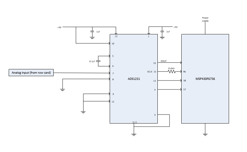

Hey team,
I have connected the ADS1231 with the MSP430F6736 as shown in the figure.
I am providing input voltage using a power supply. I am using an oscilloscope to check the output of the ADC.
The SCLK is provided by the microcontroller(SMCLK).
I have set pin #14 (PDWN) to high and pin #4(SPEED) to low.
The issue I have is, I am getting ADC output equal to voltage supply. If I change the supply from 3V to 5V I am getting the ADC output as 5V.
Even if I change the input voltage to the ADC, I am getting output voltage from the ADC equal to the VDD.
And the output is not changing even if I don't provide the SCLK from the micro-controller.
what steps do I need to follow in order to solve the issue?
Are the connections of the circuit correct?
Thank you.
  • Hi Kevin,
    Unfortunately you cannot use the ADS1231 with a single-ended input (or measurement referred to GND). The ADS1231 has a PGA which limits the common-mode input range to AVDD - 1.5V and GND +1.5V. With a 3V supply you have a very limited window. The PGA is set for a gain of 128, so if your analog supply is 3V and the reference is also 3V, the full-scale range is +/- (3V/128) or +/- 23.4mV. As you are violating the common-mode input range, you will always be seeing full-scale.
    The input to the ADS1231 is meant to accept differential inputs from Wheatstone bridges, load cells, or other similar sensors. These sensors will output a very small difference voltage approximately 1/2 of the excitation.
    Instead of driving a voltage directly into the ADS1231 I would suggest creating a resistive bridge using equal value resistors but with one leg of the bridge a potentiometer instead of a fixed value so that you can adjust or change the output voltage. Connect the intersection of the resistances to the AINP and AINN inputs. The output of the bridge will need to be less than 23.4 mV when using a 3V analog supply. Use the same supply voltage to also excite the bridge as you use for the reference/AVDD.
    If you need to make a single-ended measurement, then I would suggest looking at the ADS1220 or ADS1232.
    Bob B

  • Hi Keval,
    Sorry I misspelled your name earlier. What is the voltage range from the output of your amplifier? At 3V you have a maximum input of voltage of 23.4mV and at 5V it is 39mV for the ADS1231. This device is not meant to be used single-ended. You could make a pseudo-differential measurement by making setting the AINN input at mid-supply. But your actual input to AINP would need to be within AINN +/- 23.4 mV.
    This doesn't seem to be a practical solution. I would take a look at the ADS1220 which can actually do a single-ended measurement. The ADS1231 is not the correct part to use in this application.
    Bob B
