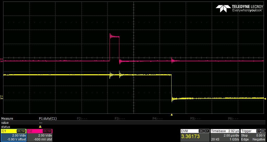

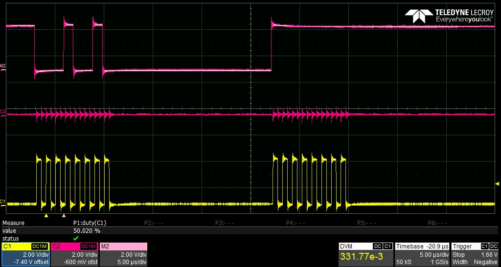

    SCLK top, MOSI middle, MISO bottom.
    This is sending RDATA 0x13, followed by 0xFF. Nothing received on MISO.
    Zoomed in on the first RDATA transaction.
    Successful SPI transaction during register reads

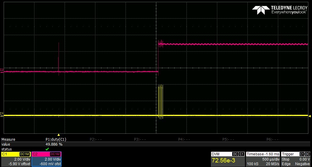

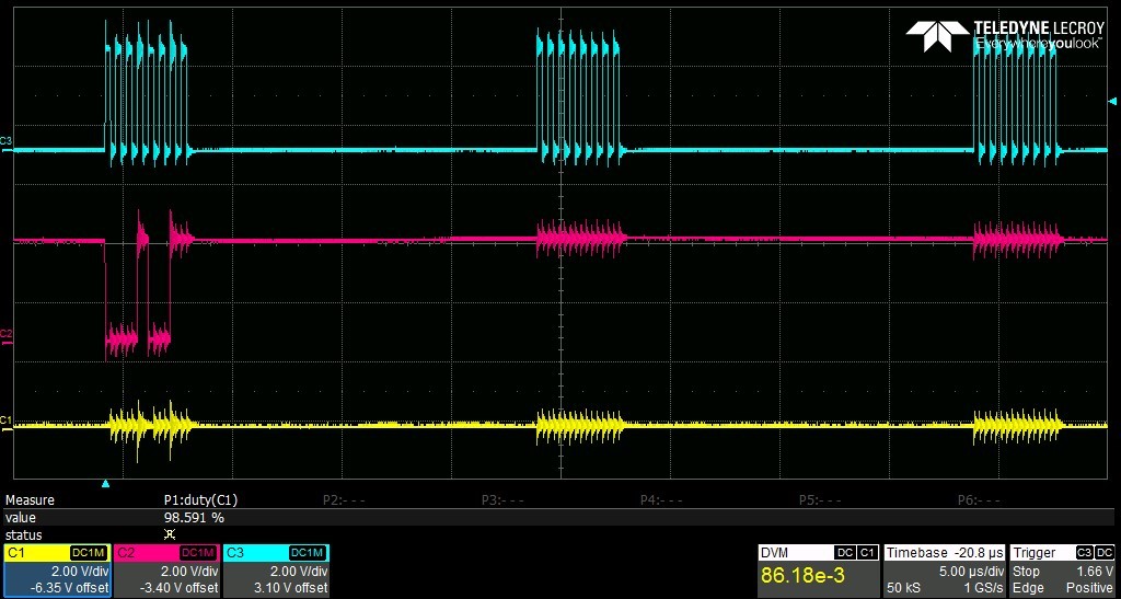

    Can you provide additional scope shots of the read data communication as well? Please include CS as well as MISO, MOSI, and SCLK.

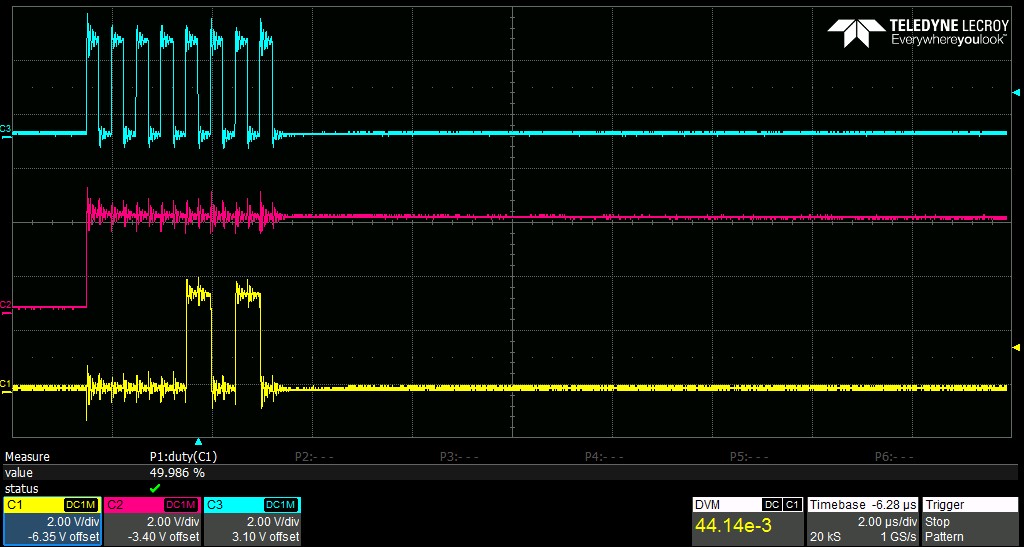

  • Probing all four of those at the same time is incredibly difficult. Instead I've done multiple 2 or 3 wire probes to piece together how they all relate to each other.
    Sending Read Command:
    MOSI, top. MISO middle, SCLK bottom
    I had to zoom out in order to see the CS
    All 24 SCKs top. /CS Bottom.
    Zoom in of 4 SCK bytes, and then CS being asserted high.

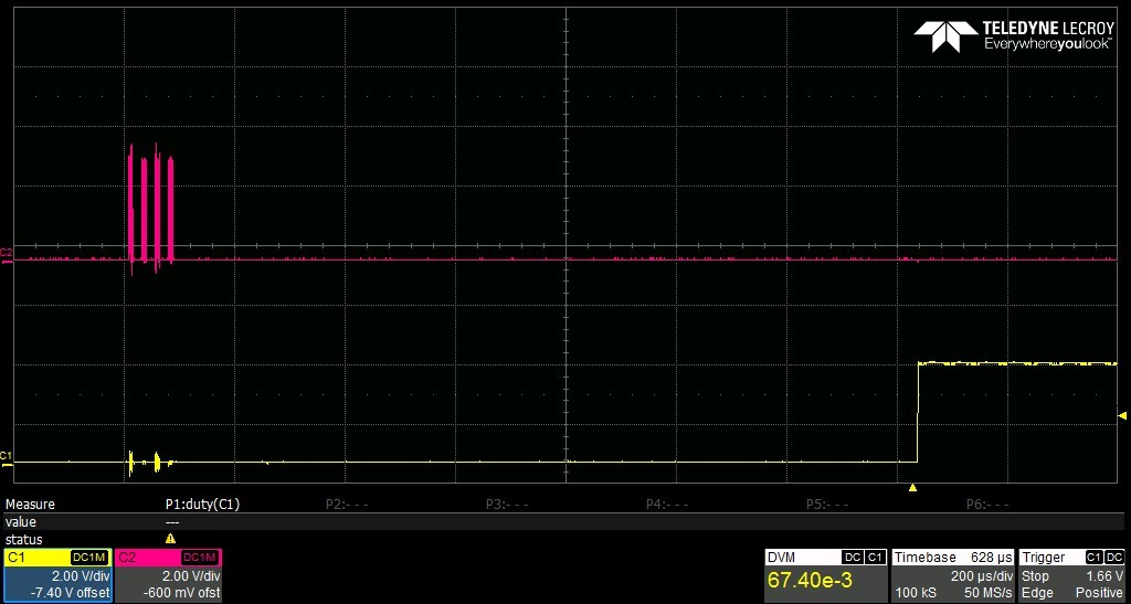

    /DRDY top, CS bottom.  CS is triggered after negative edge of DRDY
    /DRDY top, SCK bottom. After about 1.5ms, the 24 SCKs are issued. /DRDY goes high on first SCK.
    /DRDY top, /CS bottom. First DRDY pulse is hard to see, but it is slightly before CS goes low.
