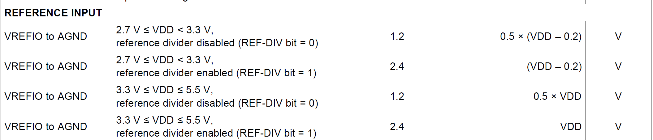

    Whats the supply voltage for DAC?
    We have specific requirements for the internal reference buffer headroom requirements. Please see the table below to configure the REF_DIV bit according to the supply, This conditions are applicable even if you are using internal reference. Failure to do so will trigger REF_ALARM bit.

    In any case, thank you for the explanation, The REF-DIV bit has to be set to 1 for internal VREF of 2.5V, all good now.
    Thank you for your help.
