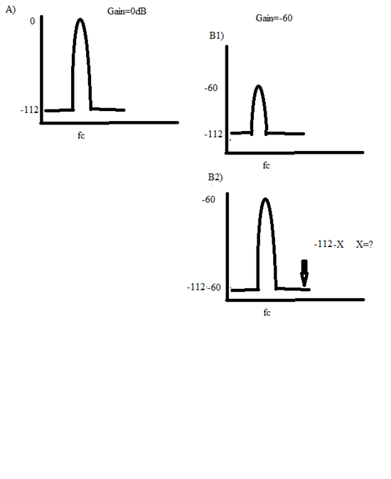

My question is related to the dynamic range (DR) of the DAC of an audio codec such as PCM3060.
In PCM3060 (for instance) the DR of the DAC is 112dB. There is also an internal volume control between 0 to -100dB.
If I've understood well, the dynamic range is given when the volume is set to 0dB. The question is if the volume reduces to -100dB (for example), how the DR changes?
In another word, does the level of floor noise remain constant and we will have a dynamic range equal to 112-100=12dB? Or the level of floor noise also reduces with the reduction of  the volume?

    I am sorry, but I still have some difficulties regarding the first question. I ask it in another way:
    When the digital volume gain is 0dB, I use the full scale input range of the DAC (24bits) and feed a pure sinusoidal wave into the DAC. Since the dynamic range of the IC is 112dB,  I would expect an output analog signal which has a peak in the frequency domain (FFT). The maximum amplitude of the peak is at 0dB level and its basal level is at  -112 dB which is the level of the floor noise. (see figure A)
    Now, I use the same digital code at the input of the DAC and set the digital volume gain to -60dB. How does the output signal power spectrum change? I know that the maximum peak will be at -60dB, but I do not know the level of the output noise. Will it be again at -112 (Figure B1) or it will be at -112-60 (figure B2) or in between (-112-X) ? (the value of X is important for me)
    Is there any graph showing the difference between the maximum peak and its basal value (i.e, X value) as a function of DAC digital gain?

  • > In another word, does the level of floor noise remain constant and we will have a dynamic range equal to 112-100=12dB?
    That's how I would interpret it. The digital volume control is just a multiplier in a digital domain. Based on my understanding of the miniDSP enabled codecs, the digital volume control is just a piece of firmware doing the multiplication. The datasheet is muddy in this regard though.

  • - According to "Vojtech" comment my answer will be "figure B1". Right?
    - What about analog gain controllers like PGA4311 or PGA2311? Does the level of floor noise reduces by the reduction of the gain?
    I am asking this question because I need high-quality signals between 0dB and 120dB (a really wide range for a medical application). If the level of the output noise does not change with the gain, for my application I need to have at least 160dB dynamic range In order to get a signal which amplitude is 0dB with 40dB SNR.  If the noise level reduces by the reduction of the gain, then I will be sure that cascading a DAC and a PGA will reach me to my solution.
    Behnam
  • Behnam,
    This is correct.  For parts like the PGA2311, they employ analog gain reduction, so the noise should go down with the gain.
