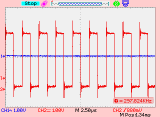

    The output on SPKP pin is like below:
    The 297.8KHz output frequency is 6.75 times 44.1KHz, not an integer multiple, nor an integer multiple of BCLK.

    I have not yet plugged a speaker to SPKP/SPKM pins but only measuring SPKP voltage using oscilloscope probes. Does DAC3100 detects presence of the speaker, and when not finding it then gives only clock-like outputs?
  • Paul,
       The class D output is in digital format and the frequency will be fixed and outputs will be in phase on both P and M outputs. When a signal is playing correctly, you should see that the frequency is varying. It is not possible to perceive the audio by looking at the signal, better to use speaker.
