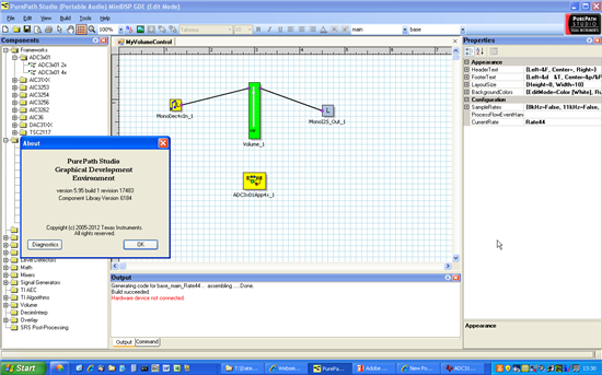

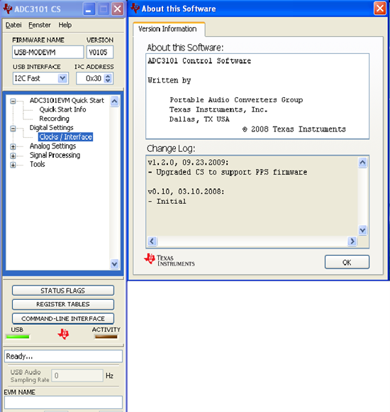

I use the TLV320ADC3101 EVM together with the USB-MODEVM. When I try to download miniDSP code via Pure Path Portable GDE, the error "Hardware Device Not Connected" is shown. I am able to connect to the board with ADC3101 CS Config Tool. Why can't Pure Path connect to the board??
Screenshot of Pure Path GDE:
Screenshot of ADC3101 CS:

  • You need to update the firmware on the EVM.
    Please use the attached firmware files.
    * flip the SW2-A2 switch on the USB modevm to the right (HI).
    * connect the EVM to the PC and follow the instructions to install the TI DFU driver (in the attached zip)
    * once the driver has installed, flip SW2-A2 to the left (LO).
    * launch DFUTest.exe
    * click Program EVM, choose file DFUEE.bin (in the attached zip) and follow the on-screen instructions
    * choose USB-miniEVM0204_441kHz.bin (or a .bin file with the desired sampling rate) and follow the on-screen instructions
    * disconnect the EVM and re-connect the EVM.
    It should now work with PPS.
