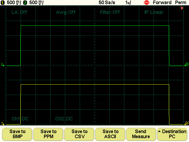

  • Hi Luis,
    thanks for your reply, but unfortunately the problem is still there.
    The following screenshot shows the output at HPLOUT/HPROUT pins of the codec while playing a silence wav for few seconds.
    Is this the expected behaviour of the codec?
    If not, is there any possible cause for this jumps?
    BR
    Pier
  • Hi, Pier,
    The HPLOUT/HPROUT pop issues can be reduced with Page 0 / Register 42. This register determines the power-on time and also the ramp-up step time. I recommend to add a considerably high step time (4ms) and about 100ms of driver power-on time.
