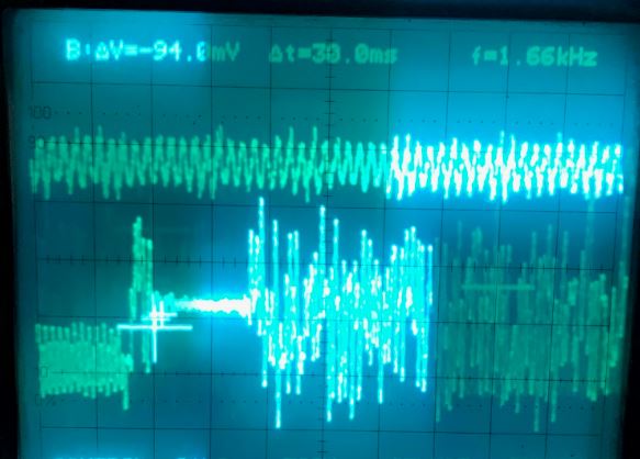

  • Hi Steve,
    Thank you for your reply.  We are using our own design. What we do is looping ADC signal back to DAC.  input signal is sine wave 1KHZ, when sampling frequency is 48KHZ we are getting perfect sine wave at the DAC output. Once we try to lower down sampling frequency we getting some kind random noise: signal swings from 0V to VDD with relatively high frequency there is no specific pattern , see bellow. top line is input signal and bottom DAC output. All we do changing register 02 from 0x0 to 0xAA
    Please advise.

  • hi Stalker,
    Do you change the clock rates while the ADC and DAC are powered up? if you power them down and then change the clock rates does the issue persist?
    I have an EVM here and I am unable to reproduce the problem.
    can you provide all of your register settings?

  • Hi Steve,
    Thank you for your replay: I try two things:
    1. to change register 0x02 when ADC/DAC both are powered up;
    2. change register 0x02 first thing after releasing reset line
    In both cases result is the same.
    My  register settings:
     i2cWrite(AIC3101_I2C_ADDR, AIC3101_SAMPLE_RATE_REG, 0xAA);   AA is bad; 0x0 works
    i2cWrite(AIC3101_I2C_ADDR, AIC3101_CLK_GEN_REG,2)
    i2cWrite(AIC3101_I2C_ADDR, AIC3101_CLK_REG, 0)
    i2cWrite(AIC3101_I2C_ADDR, AIC3101_PLL_A_REG,0x81);
    i2cWrite(AIC3101_I2C_ADDR, AIC3101_PLL_B_REG,0x18);
    i2cWrite(AIC3101_I2C_ADDR, AIC3101_PLL_C_REG,0x16);
    i2cWrite(AIC3101_I2C_ADDR, AIC3101_PLL_D_REG, 0x80);
    i2cWrite(AIC3101_I2C_ADDR, AIC3101_OVERF_REG,1);
    i2cWrite(AIC3101_I2C_ADDR, AIC3101_ASDI_A_REG, 0xD0);
    i2cWrite(AIC3101_I2C_ADDR, AIC3101_ASDI_B_REG,0);
    i2cWrite(AIC3101_I2C_ADDR, AIC3101_DATA_PATH_REG, 0x08);
    i2cWrite(AIC3101_I2C_ADDR, AIC3101_MIC2L_TO_LADC_REG, 0x0F);
    i2cWrite(AIC3101_I2C_ADDR, AIC3101_LADC_PGA_REG, 70);
    i2cWrite(AIC3101_I2C_ADDR, AIC3101_MIC1LP_CNTR_REG, 0x07);
     i2cWrite(AIC3101_I2C_ADDR, AIC3101_LDAC_VOLUME_REG, 0);
    i2cWrite(AIC3101_I2C_ADDR, AIC3101_DAC_PWR_CNTR_REG, 0xA0);
    i2cWrite(AIC3101_I2C_ADDR, AIC3101_DAC_OUT_SW_REG, 0);
    i2cWrite(AIC3101_I2C_ADDR, AIC3101_DAC_L1_HPLOUT,0x80);
    i2cWrite(AIC3101_I2C_ADDR, AIC3101_HPLOUT_VOL_CNTR_REG, 0x09);
    Please have a look and advise.
