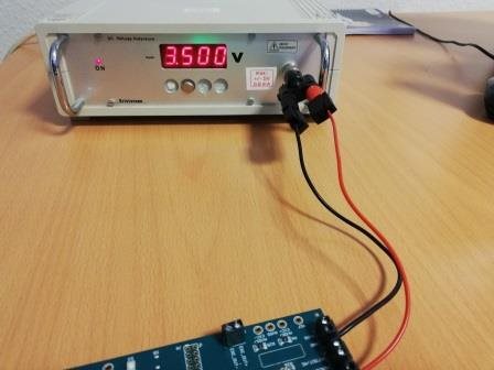

    Now I've managed to get a first measurement. I set my external power voltage supply to 3.5V (Iout,max is rated as 0.8mA) and I got this result:
    The only thing I can't quite rap my head around is the fact that I only get a value somewhat close to my set inputvoltage if I set VRef in the Data Analysis Tab to 5V. If I don't, I simply get a fraction of the estimated value. If I set it to 2.5V I get halfe of what I expect. I'm not quite sure why this is happening, but I think I simply don't understand the concept of the reference yet. I'm gonna do some more digging in the manuals and datasheets.

  • Hi Martin,
    I noticed that you're are configuring the ADS1261 to measure the differential voltage between AIN0 and Internal VCOM, and for the reference voltage you are selecting the differential voltage between AVDD and the internal REF N.
    Please note that "Internal VCOM" is connected to a mid-supply voltage (~2.5V). Therefore, the ADC is measuring the differential voltage between AIN0 and 2.5V. This is probably why you are only measuring half of the voltage you are expecting.
    For the reference configuration, I would recommend setting RMUXP and RMUXN to either be connected to the internal 2.5V reference OR the internal ~5V supply reference. Whichever one you select will set the maximum input voltage you can measure (you can never measure a differential input voltage that is greater than VREF / PGA).You must then also tell the GUI if the ADS1261 is connected to the 2.5V or 5V reference so that it can properly scale the voltage correctly on time-domain plot.
    I hope that helps!
