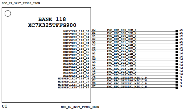

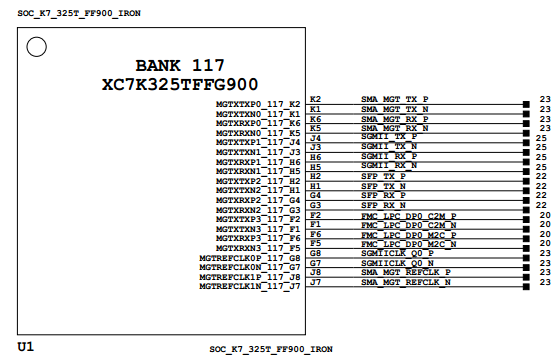

  • While waiting for the KCU105 support, I built the reference design targeted for KC705 and I had a question about the number of JESD lanes connecting the Virtex 7 FPGA on KC705 to the ADC on ADC12J4000EVM board.
    I noticed that the JESD_PHY block is using 4 GTX transceivers each from Bank 117 and 118 for a total of 8 JESD lanes [1]. But according to the KC705 schematic, the FMC HPC connector is only wired to 4 GTX transceivers from Bank 118. The other 4 transceivers on Bank 117 are wired to SFP and SMA [2].
    How does the TSW14J10EVM reference design establish an 8-lane JESD connection to ADC12J400 on the ADC12J400EVM?

    [2] From the KC705 Schematic:
  • Hi Ranjeet
    You are correct, the KC705 only has 4 RX lanes routed to the FMC connector. This limits the ADC12J4000 to the decimation modes that use 4 or fewer lanes when used with the KC705.
    The VC707 has 8 RX lanes, and does support the ADC12J4000 DDC Bypass mode which uses 8 lanes.
    Jim B
