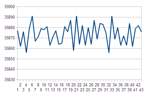

If this command is not issued, does calibration always take effect?
As the current operation, when inputting GND data and making settings,
clean data is input, but if you input a signal in that state,
it will become unreliable waveform that the interleave correction has collapsed Will be input.
I tried freezing the above site and it works normally but please do not check it because it is not listed on the data sheet.

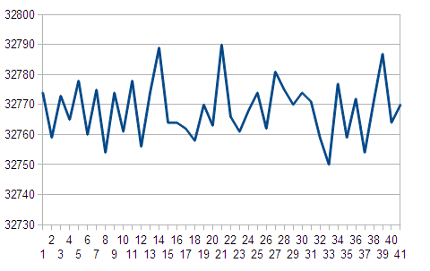

    When GND data is input, data can be acquired without problems.
    However, when inputting something other than GND data (for example, sine wave or DC component),
    the interleave correction of the four cores does not work well and the waveforms are disjointed.
    By using the IL Freeze function at the present time, we have used the provisional waveform because the waveform is set to some extent.
    Is the IL Freeze function normal operation, is it okay to recognize that it is essentially an unnecessary function?
    Please tell me the correction procedure for Interleave correction function.
    (Can you adjust the correction with register setting?)
    When GND data is entered in the attached file (GND.png),
    when DC data is input, the waveform of the waveform (DC_freeze.png) obtained when DC data is acquired after using the freeze function will be attached So,
    I think if you can confirm it.
    (In DC.png, it is DC data, although the four cores can not be balanced and it looks like a waveform)

    Is there a wrong way to check the correction function of interleave correction?
    I think that it inputs 0 V to each channel and corrects that gain and offset.
    However, there is a difference in data of each channel (DC.png).
    What may be the cause?
