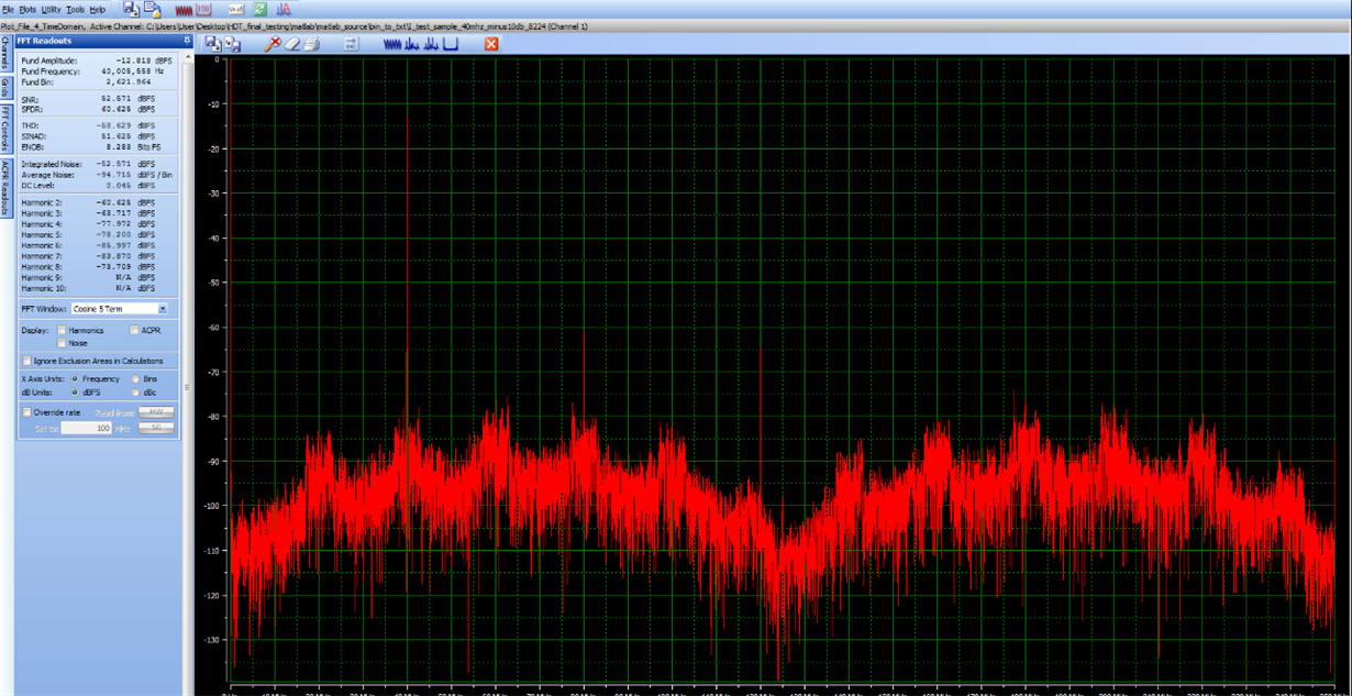

I am using ADS54J60 for one of our application.
i am receiving 40 MHZ base band signal while doing sampling at 500 MSPS (with out enabling internal filter):
Results are as fallows on wave vision:
I want to know why noise floor coming like Bow instead of flat?
i am also getting harmonics @ 80 MHz,120 MHz.
Anti aliasing filter cut off frequency is 280 MHz
Is there any harmonics/noise improvement through this IC internally?
  • Shivakant,
    Are you using an ADS54J60EVM connected to an older National Capture card and running Wavevision? If so, this is a setup we have never tried before. Normally this EVM is tested with a TSW14J56EVM. Can you send the register settings for the ADC? If this the TI EVM, send the LMK settings as well.
    Jim
  • Hello Jim,
    I am not using ADS54J60EVM .
    I designed a board in which i am using this IC which is interfaced with FPGA.
    Data coming from ADC is getting captured in a .bin file & i am plotting this data in wave vision.
    Please find the register setting for the above ADC:

  • Shivakant,
    I tried your settings with our EVM using the on-board VCXO  for one test and an external 500MHz for another test. In both cases the results looked fine. Are you using a filter on your analog input? How clean is your clock source?
    Jim
    ADS54J60_Fs_500M_IF_40M.pptx
  • Also make sure to give the ADC a hard reset after the clock is present but before you program the registers.
