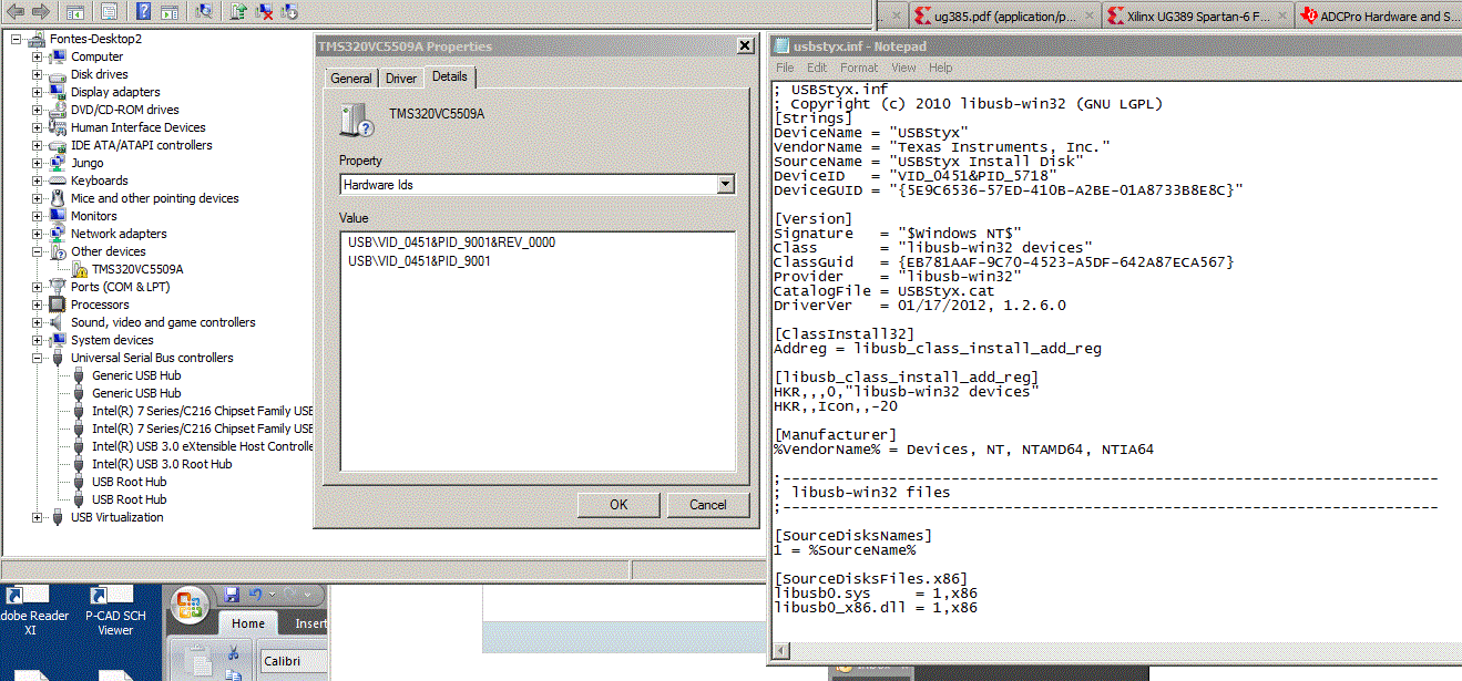

  • I am posting a status because I have still not been able to get the kit going.  I have now tried two of the kits, each having a different MMB0 design board, on three different computers, with the 64bit Windows 7, and 2 Windows XP Pro systems.  I have downloaded the latest ADCPro on each system and installed it.  I have downloaded the ADS1274 EVM Plugin on each machine.
    I am still stuck with the problem that none of the machines recognizes the kit board as the NI-VISA devices as the documentation indicates.  All machines recognize and "Unknown Device", and will not allow me to load a new driver.  When I Browse to the USBStyx.inf file the device manager tells me the file does not match the hardware installed.
    When I run the ADCPro program it sees a device connected, says the device is not programmed, tries to reprogram it and fails.  If I try to do anything with the ADCPro after that which attempts to communicate to the kit, I receive messageboxes telling me that there were timeout failures when talking to the kit device.

  • I have been working with the Windows 7 64bit machine this morning trying to figure out where the install failures.  I have the system recognizing the MMB0 as a TI TMS320VC5509A Device, that will not use the ISBStyx.inf to load drivers.  I have started looking at property windows and inf file contents and I see something that doesn't look right to me.look right to me. The device IDs from the Device manager properties and the inf file don't match.  Does anyone know if this is right or not?
  • Mike -
    The driver that you are trying to force in is not the correct driver, so therefore your observations regarding the PID/VID are accurate.  You need the inf files located @ C:\Program Files (x86)\ADCPro\pdk_lib\libmmb0\Styx\mmb0_drivers (or similar, depending on your computer and platform).  The "vista&7" file is for Win7, the other for WinXP.  Some additional software information for the installation process is available @ http://www.ti.com/lit/ug/slau372a/slau372a.pdf.
    At this point, there may be some issues caused by all the installation and different versions, given that Windows doesn't always forget everything that it is supposed to when you "remove" a driver.  You will probably want to uninstall the the software and ensure all driver related files are removed.  This may be a little tedious, but I don't know of any other methods.  There will be the dll files, and inf files, both the ones shown and the ones that have been incorporated into the oem files.  Care should be taken when doing this to prevent deleting any system files that might cause other things to work.

    2. I have looked at the directions that are in the slau372a.pdf file and there is a very important difference between what I am getting and what the directions show.  At NO TIME do I ever get an indication from Windows that the device is an NI-VISA device.  It is ALWAYS and UNKNOWN DEVICE.  Therefore Windows is not able to find a correct driver for the new device.
    3.  Out of curiosity I have attempted to point the device manager driver installation to every .inf file in the ADCPro subdirectory structure that I could find.  It does not accept any of them as a match for the mmb0 board hardware.
    I am convinced that the correct dlls are in the directories I have but that Windows does not want to install the correct one.  Can you tell me a way to get past this problem?

    When the device shows up as "Unknown", can you tell us what the VID/PID is showing?  Should be VID = 0451, PID=9001.
    Additionally, do you have anything else on your computer that uses LabVIEW or NI-VISA?  Just looking for possible contentions.
    Is there a good email that we can send emails with attachments to?
  • Greg,
    The VID and PID are correct as you showed them.  You can see that in my previous posts. There are no other NI- VISA or Labview apps on this machine.  It is fairly new, and only has minimum installed programs at this point. I also share some questions as when I look up the VID and PID the board is reporting on the web it shows me a TI NI_VISA device.  The trouble is that Windows doesn't think that.  How far back do you want me to uninstall.  I can remove ADCPro again.  I'm not sure what registry entries to remove if you want me to go there.
