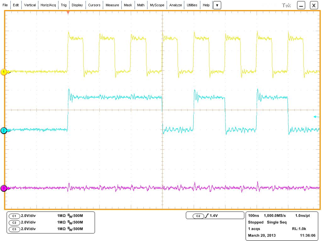

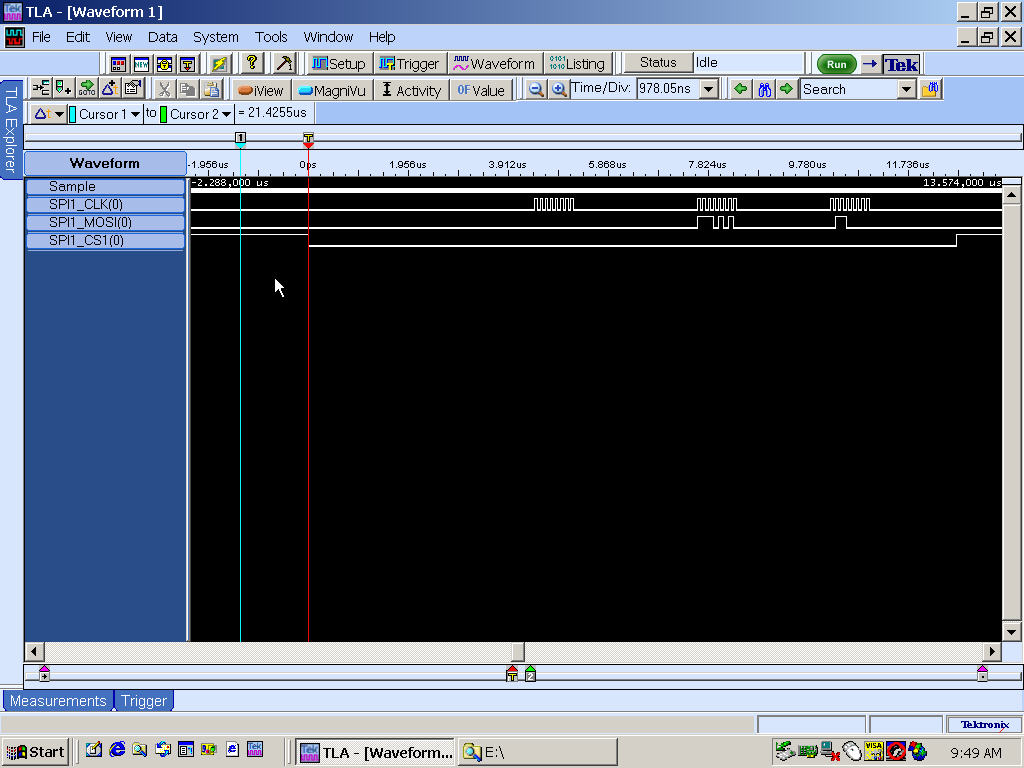

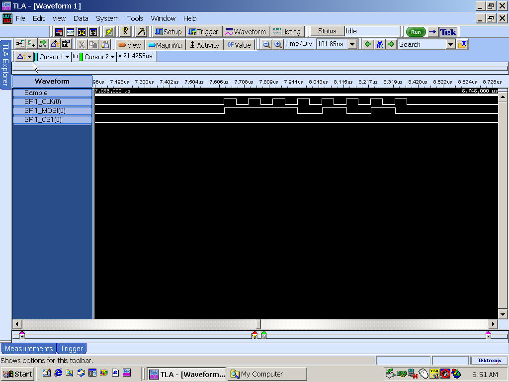

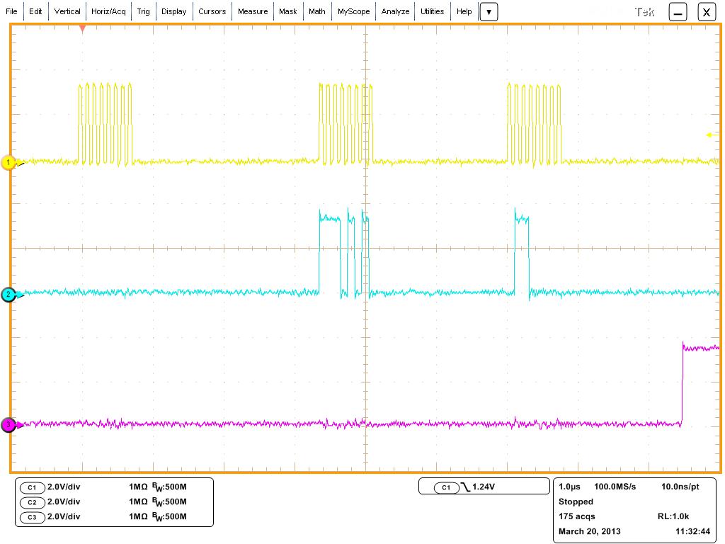

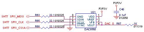

I have a DAC8560 on 2 prototype PCBs.
They both behave the same, VREF is putting out, but the DAC output does not no matter what code is sent to it.
I have verifed the SPI inputs with logic analyzer an oscope.
I ordered more parts in case I have 2 bad parts, but I doubt it.
Please see the attached logic analyzer traces and circuit.
Am I doing something wrong?
