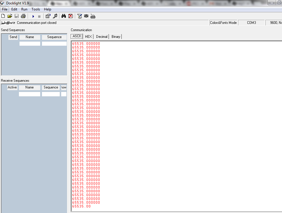

Hi i am using pic30f5011 (16 bit ) controller and mplabc30 compiler,to observe the output of the program i am using terminal programming....
My task is to read Voltage readings by using ADS1118, i am new to SPI and And ADS1118...
while running my code no errors... its showing output as 65536.. !

am i missing something in SPI or ADS1118? plz help me anyone
showing output like this :

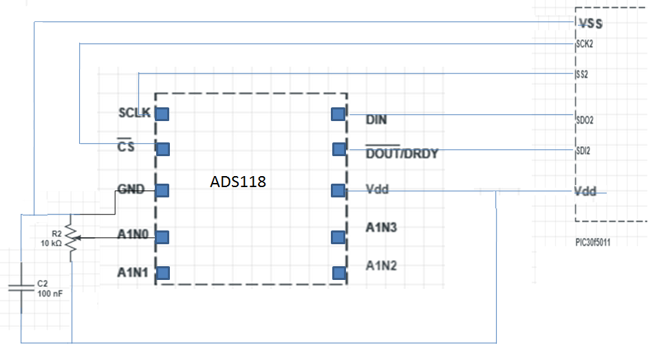

  • My hardware connections are like this
    ADS1118 vs  Microcontroller connection is like this
    SCLK--------->SCLK
    CS ----------->CS
    SDO---------->SDI
    SDI----------->SDO
    4 Pullup resistors(4.7k) connected to SDO,SDI,SCLK,CS
    And Variable pot(10k) is connected to ADS1118 analog channel AIN0 (ADS1118 -4th pin) to vary the in put voltage to ADS1118

    We have seen your code, but not your schematic.  There may be some additional items that we are overlooking.  If you could send us the schematic it would be helpful.
    Bob B

  • schematic for my code
  • Hi Naga,
    I see we are making a little progress, but those results are not satisfactory yet.
    What is your register setting of bits MUX[2:0] in that case? It was '000' before as far as I saw.
    It should be '100' in this case.
    As I mentioned before it might be better to use input AIN1 as the negative input and connect the terminal of the pot that is currently connected to GND to AIN1.
