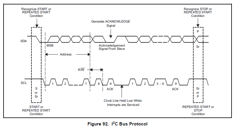

Looking at Figure 92 you can see that I2C sends byte (8bits) sized packets followed by an ACK. Typically the first byte is reserved for the address of the device and each byte following that is information for the slave device.

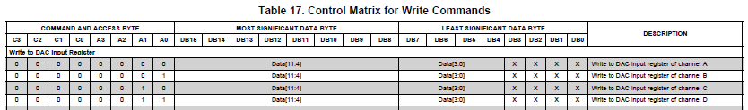

Table 7 shows that the complete DAC7678 I2C interface consists of 4 bytes, including the address byte.
In order to know what information to include in the Command, MSDB & LSDB bytes you must look at the control matrix in Table 17. I only included a small snippet for reference, but I recommend that you look at the full table in the datasheet.
