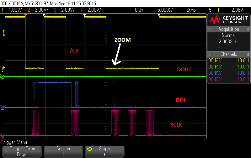

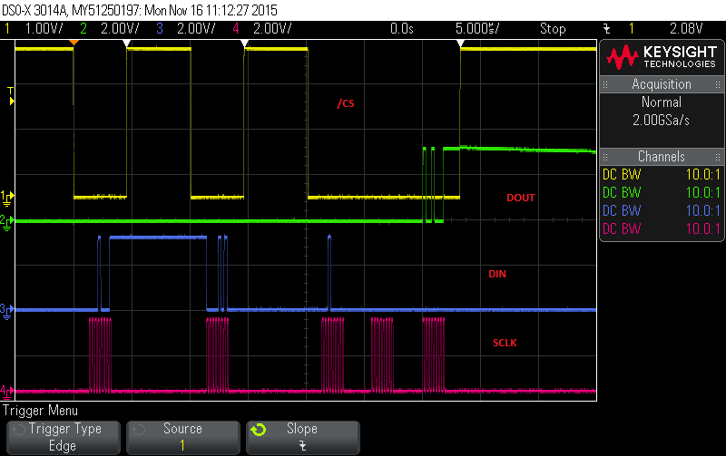

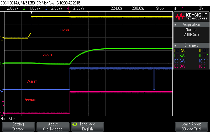

  • Hello Brian,
    Please find here the scope images:
    Power up:
    SDATAC + STOP + Read ID => OK:
    SDATAC + STOP + Read ID  => KO  (occurs about 10% at power up):

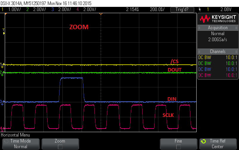

    read ID zoom on first byte:
    As the microcontrolleur is a TI MSP430F5419A, please find SPI configuration:

  • Hey Michel,
    The protocol looks good too. Can you tie START high after power up or issue the START command and see if DRDY is coming as expected? If not it could indicate a power up issue.

  • Hey Michel,
    You are issuing the SDATAC command before you read the registers which is the only requirement. Plus you are waiting a really long time in between all of the power-up sequence steps so I don't think that's the issue. Looking at that other post, it seems like both issues are related to communications working infrequently (though in the other post it looks like issuing the RDATA command is actually working). Could it be a cold solder joint on one of the SPI pins? Have you tried different hardware?

    I look at the ADS1299 signals at the oscilloscope: at PCBA power up /RESET, /PWDN and /CS are set to high immediatly with DVDD. /RESET is set low only when the IHM is linked to the PCBA. That's means many minutes after the power up.
    Despite I have never seen the big delay in your datasheet, I will try it.
