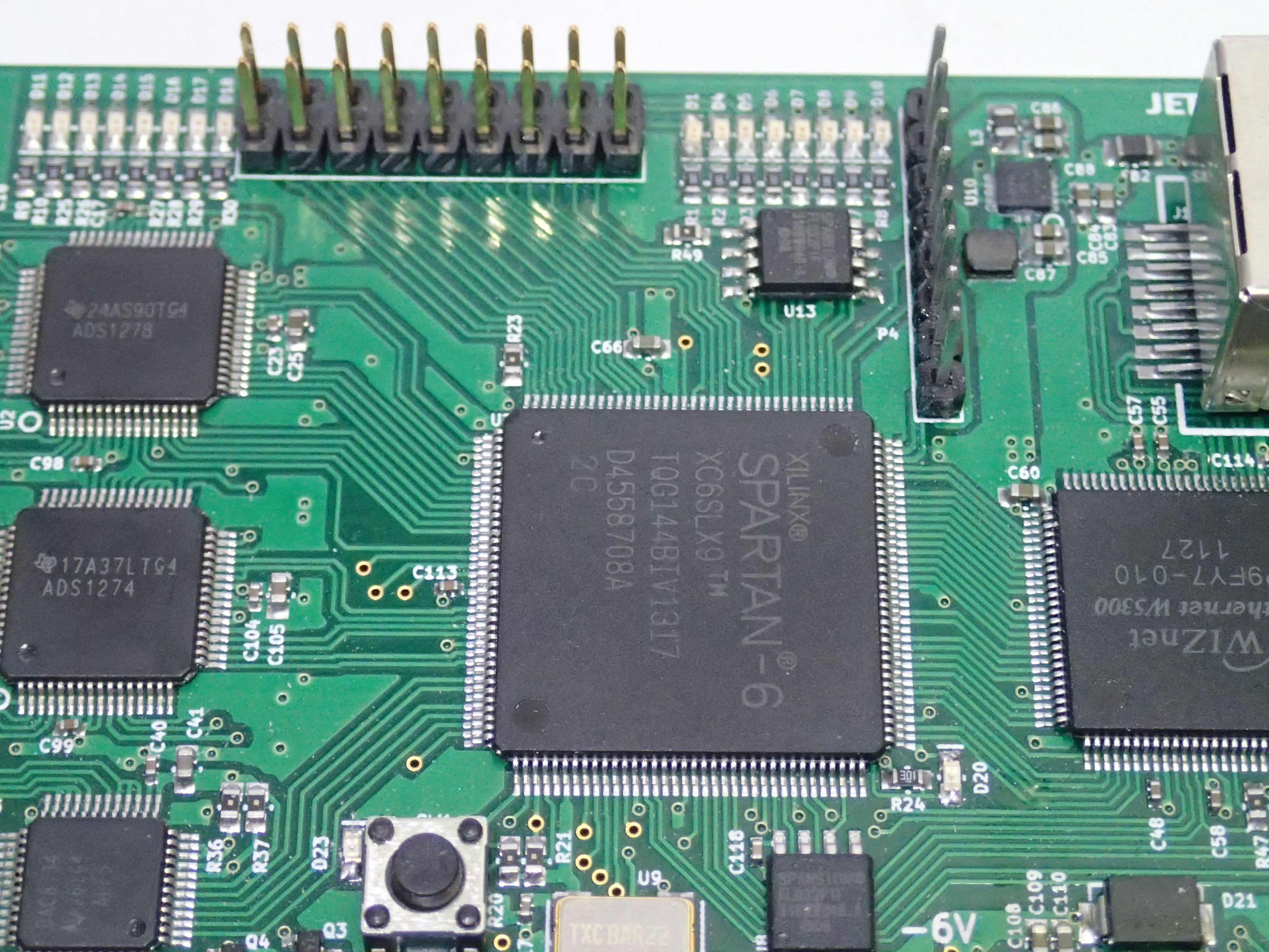

Well, I completed a side project where I have put an ADS1278 + ADS1274 + DAC8734 on the same small EVM PCB, with a common clock and ref voltage source. The SPI data from the ADCs is aggregated with a Spartan6, and sent out over Ethernet with a Wiznet W5300 chip at full rate - 24 bits, 48kHz, 12 simultaneous channels. The data is sent out as UDP packets every 1ms, so latency is very low. Streaming only starts when a client connects to the EVM and requests data. Prior to that, the EVM sits idly by and broadcasts its presence every few seconds for easy discovery.
Meanwhile, the DAC8734 outputs 4 simultaneous waveforms from on-board non-volatile memory at 96kHz. The Spartan6 uses hardware multipliers to permit real-time volume modifications by UDP commands that the EVM receives.
This board has very low latency, real-time data streaming, low noise, and great reliability. Requires no USB drivers, and the UDP packets are easy to parse.
So my question is - is there some interest in an EVM like this? I am considering whether I should put some time into making this a kickstarter project or something similar.
Feedback, please.

    It looks like you've put in a lot of work in this project. While at TI, we generally will roll our own EVMs so that we can support a wide variety of devices, there might be others interested in your work. Posting a kickstarter project might be a good idea

    Following up on Joseph's comments, our EVMs are supposed to allow customers to quickly evaluate our devices.
    I work for the precision DAC group, so I can only speak about the DAC EVMs. While your solution will allow some customers to get information with a lower latency than an USB solution, others will not utilize the full capabilities of your design, while others will require even faster rates that can only be achieved via direct SPI or parallel interfaces. In other words, we have a large spectrum of customers that use our devices, sometimes for only their precision, sometimes their speed, or both. Our EVMs only attempts to attempt to showcase certain features of the device, while keeping the cost relatively low so the customer can more confidently start designing their own solution that is optimized for their particular application.
