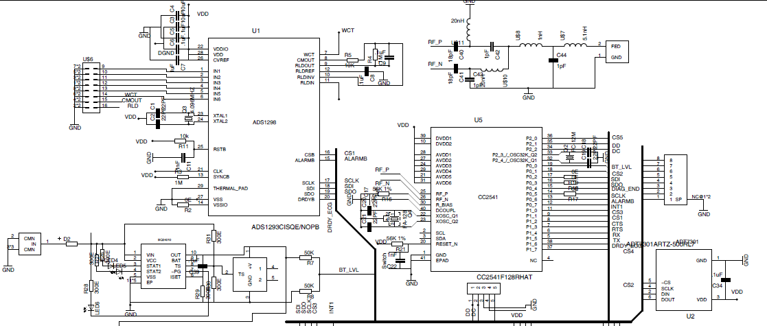

Hi, I am trying to communicate ADS1293 and CC2541 through SPI. I used the code given in the TI website, in the firmware uploaded, through the following link:-
www.ti.com/tool/TIDA-9600#technicaldocuments
The bluetooth communication is functioning properly but I am getting all data as FF:FF:FF:FF......:FF:FF, after I removed the "if (send_buff != NULL)" condition. That means I am not getting any data from ADS1293. Secondly I examined the SPI communication between ADS1293 and CC2541 by writing a particular value to a register and reading it back continuously. I observed proper waveforms on SCLK,CS and MOSI pin, but nothing could be observed on MISO pin. That implies registers of ADS1293 are not written. I used the following code for testing SPI communication.  I am also providing my schematic along with this. Please help me figure out the problem, I have been on this for quite a number of days but am unable find out the solution. Please help me out!

  • I couldn't open your uploaded schematic. It looks to me you have changed the USART0 pins for Alternative -1 from Alternative-2. Good to check there's no pin conflict because of this change in your EVM or board setup. Also, please check the SPI interface setup code. Initially, better to keep it the same as in the TI design firmware function ADS123_SPISetup. You need to keep clock phase/polarity and msb first initializations same. Thanks.
  • Thank you very much for your reply. I changed the bit order to MSB first and obtained waveforms on MOSI pins. Now I am able to properly receive ECG data on notification handle over bluetooth.
    Thank you for your help.
