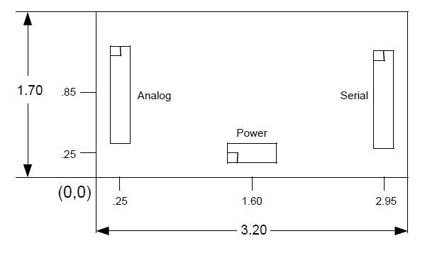

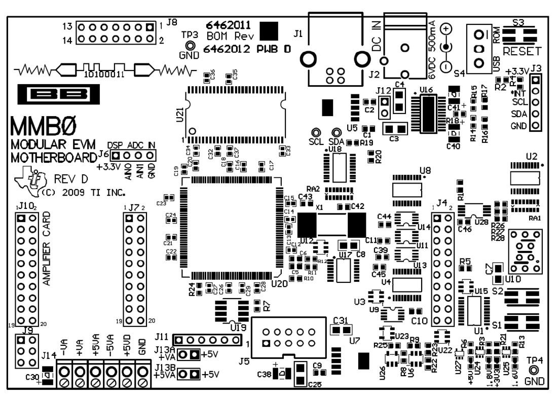

I plan on layouting a little board to plug in on top of the EVM to which the input connectors will be routed. For this I am looking for some mechanical data. I found the design data here e2e.ti.com/.../2680.ads1158-ads1258 but as I don't own protel, I have no way of extracting them. (I'd also be interested of the screw positions of the PDK motherboard, so I can design the whole thing into an enclosure (with fitting connectors to the outside world, differential amp and VRef if needed). (I am using eagle)

    You're welcome to use the ADS1258EVM as you like for evaluation purposes and I can provide you with the EVM mechanical information, but please note that assembling the EVM into a finished product would violate TI's standard terms and conditions for evaluations modules. If the assembly is part of your evaluation, than likely this is not an issue.
    The EVM headers have the following dimensions:
    (Units are in inches. Note that the ADS1258EVM may not be exactly 3.2 x 1.7 inches in dimension; however, the relative header positions will be the same as indicated.)
    Note the latest MMB0 (Rev D.) does not have any screw-holes:
    (It does have four adhesive bumpers on the back side, for which only the through hole components would limit the placement of these. The MMB0 is about 4.75 x 3.25 inches.)

    Hi Christopher,
    thank you very much. Yes, the assembly is part of the evaluation, it will go into an aluminium box to reduce interferences and there will be a pcb on top to mount the connectors neatly and put the amplifier (OPA365 from ADS1258 data sheet) in between MUX out and ADC in.
    The second analog port seems centered to the left one in y direction and offset to the right by about 500 mils?

  • Hi Pio,
    I should have also mentioned that the 20-pin connector on the top of the EVM is a Samtec TSM-110-01-T-DV. Its mating pair is the Samtec SSW-110-F-D-VS-K. So the pins have 100 mil pitch and the diagram above indicates the center of the connector. Therefore, the "Serial" connector need to be 2,700 mils to the right of the "Analog" connector (when looking from the top), for example.
