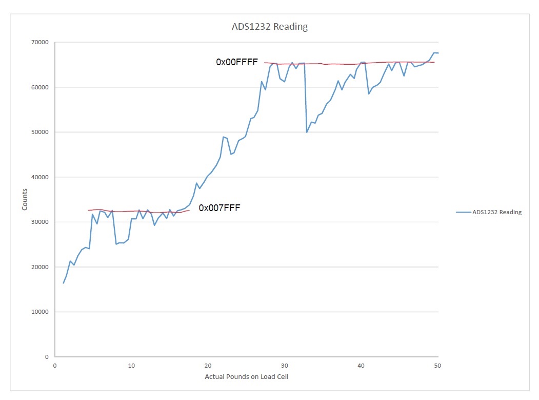

My issue is really unusual.  My analog input off of the load cell (in mV) is perfectly linear all the way up to the chip pins.  Once the signal gets into the chip, it is a different story.  The digital output is having issues "rolling over" to the next Most Significant Bit.  It will roll over from 0x003FFF to 0x004000.  It seems to be linear up until about 0x005FFF.  It will roll over from 0x005FFF to 0x007***, and fumble around with the bits while the pressure rises up to 0x007FFF and then it will double back to 0x007C00 until you finally run it up to 0x007FFF again, and then the MSB will finally increment so that you get 0x008000.  After this, it seems to be linear up to 0x00EFFF and then it strays from the path again between 0x00FFFF.  Eventually it will roll over to 0x010000, but this is about the limit of my load cell.
I have hard-wired an external reference voltage into it with no success.  I have changed the input capacitor (C45) with no change, but the signal is fine there on a scope or DVM.  I've tried changing the gain and the speed with no success.  I initiate a zero offset calibration at start-up and don't again after that.  Again, I am using the same components as on the demo board for the most part.

    Below is the resulting curve from my tests incrementing the load in 1/2# increments.  This is showing how it is doubling over.
    I have done about as much as I can think of with your advice.  I removed the choke and jumped it.  I jumped just the GND side, and I also jumped just the GND side, but installed a 33uF Tantalum capacitor at that junction.  This didn't make any difference.  I also added a 0.1uF and a 0.01uF ceramic capacitor in parallel with the 2.2uF capacitors for the decoupling for both supplies.  These are placed very close to the power pins for the chip.  I removed the ground jump from where I jumped the missing choke, and I added a single ground merge right at the ADC power pins so that was the only place they came together to eliminate all possibility of potential between them...it still didn't work.  I added the 33uF Tantalum cap there for fun to see if it would help, and it did not.  I removed the analog supply all together and added an external supply, which didn't solve the problem.
    For these measurements, I am running the system in a gain of 1 (Gain0 & Gain1 = Low). and the speed is low to get 10Hz.  Obviously I am running an external crystal, but I have also jumped the clock-in to ground to activate the internal oscillator, and this didn't make a difference.
    I am attaching the raw Excel file with the data if you would like to check it out.  Again, I would sincerely appreciate the input here.  I am really pulling out all the stops (so I believe) to get this working and am coming up with Nil so far.  Thanks again.

  • Hello again, Bob.
    I have been diligently working on this project since our correspondence and I have identified the issue.  To cut to the chase, the "silver bullet" was when I removed the choke, and instead of just jumping the choke, I had to move the ground merge to a wire that was right over top of the ADS1232.  With that as the ground merge, the problem went away.  Here is a chart with the compilation of the results:
    To answer your questions, I have done all of my testing in the real world.  I am using an actuator to push a spring that is attached to a scale, and I have a load cell on the end of the actuator telling me how hard it is pushing.  I have a microcontroller keeping track of all of this, so I am running it on a debugger the whole time.  I am pausing the execution after I get to my set-point and recording the results that are in the actual registers.
    Since it was still within the linear range, I increased the gain to x64, which also helped.  I did all of my testing at that gain setting.
    Again, I sincerely appreciate your input on this, Ben.  Your saying "odd problems" resulting in differences in potential across the grounds turns out to practically be an understatement.  My choke was only about 3/8" away from the ADC, so I was genuinely surprised when moving the ground merge that small of a distance made such an enormous difference in the results.  Results are results, so in hopes to benefit my fellow engineers, I post the results of my testing.
