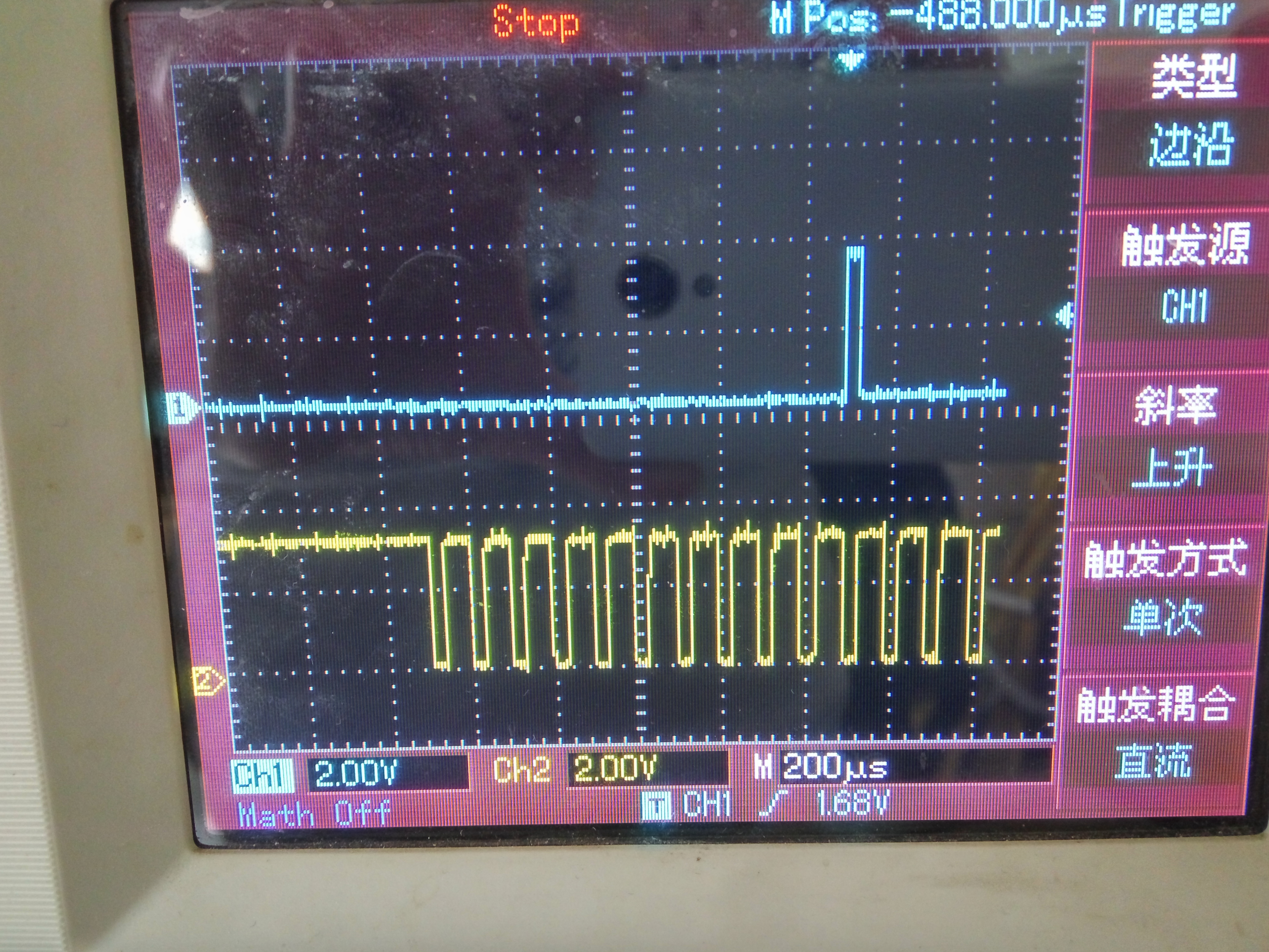

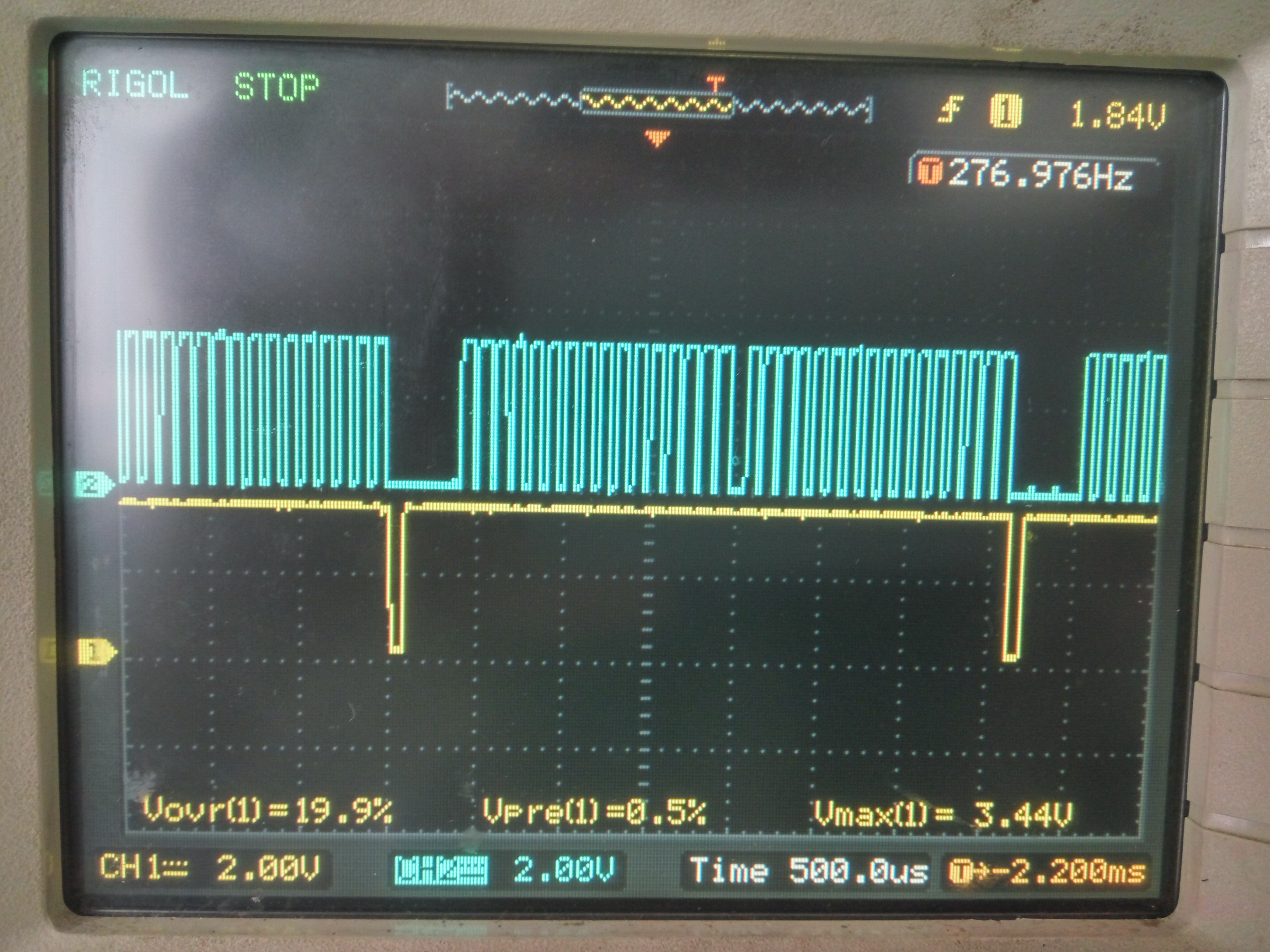

I got a problem when i was reading datas from ADS8866.I gave it 16 clocks,but I could only get 15bits,the last one was always at  a wrong level,just like this:

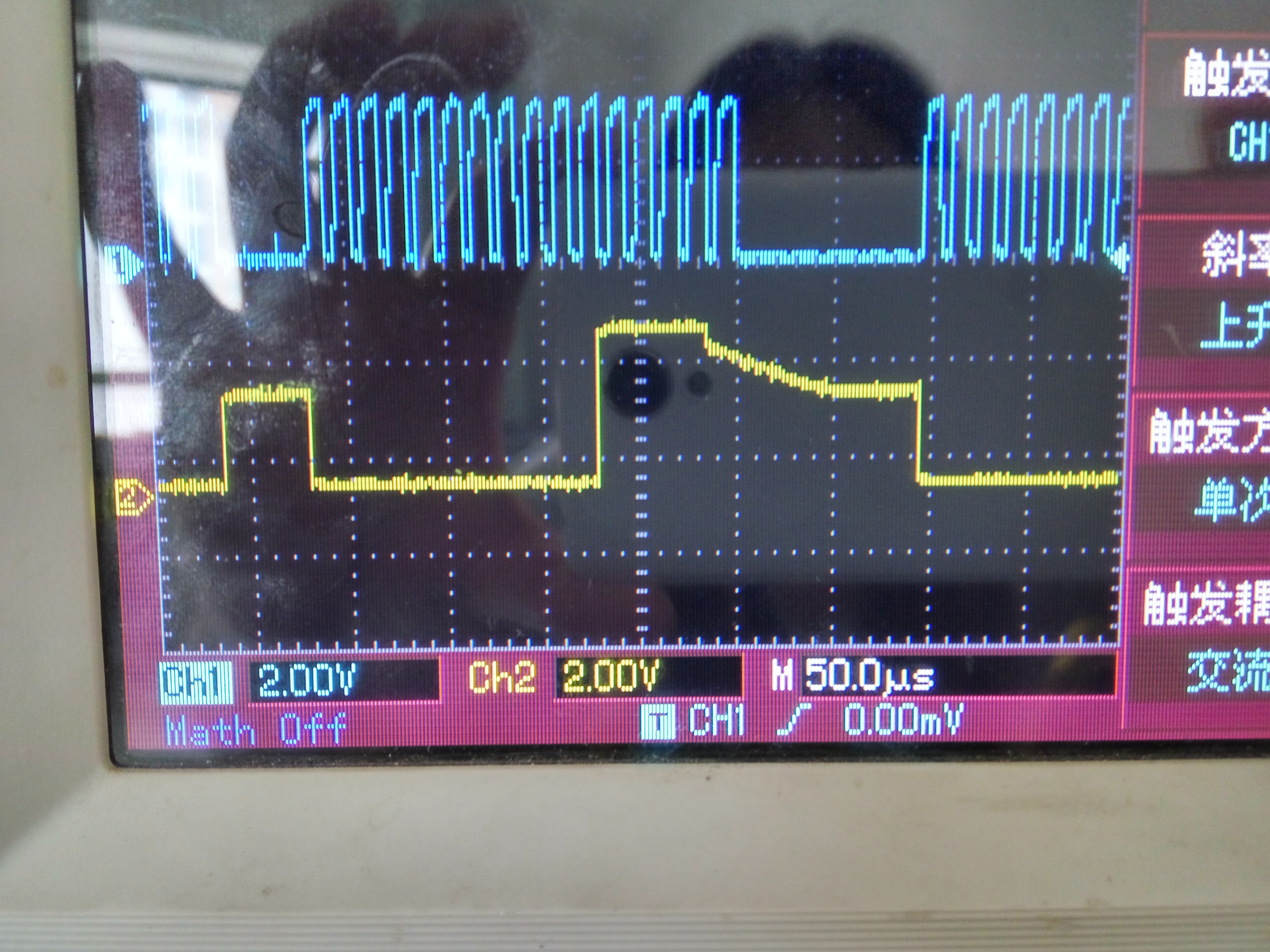

Sometimes not only the last one,bits of them were all wrong,like this

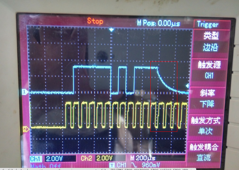

Even more,I got this one
the device outputs datas both at SCLK falling adge and rising adge.

    I am looking into the issue. To help, can you please:
    1) Provide a DC input to the ADC and tell me what it is.
    2) Take a photo of CONVST, DOUT, and SCLK all on the oscilloscope at once. If you only have two scope inputs, then please capture CONVST and SCLK, then with the same DC input capture DOUT and SCLK.
    3) What is the DVDD voltage in your system?
    4) What is the reference voltage?
  • The DC input to ADC is 1V,the VDD is 3.3V,the REF is 5V.I used 2 pieces of AD8866,4-wire CS mode.
    This is CONVST and SCLK
    Then DOUT and SCLK
    This is for the details
    This is DIN and SCLK
  • At most times,I can get the right data on DOUT.
    Time of CONVST , DIN and SCLK are just like they are on these photos,I didn't catch a wrong one ever.
    Do you have a pull down resistor on the DOUT trace? If not, can you add one (10 kohm connecting the trace and ground would work) and test again?
    It appears that at the end of the cycle the ADC output is tri-stating, allowing the DOUT trace to float. Without a pull down resistor, the voltage on the trace (which has capacitance) will slowly discharge.

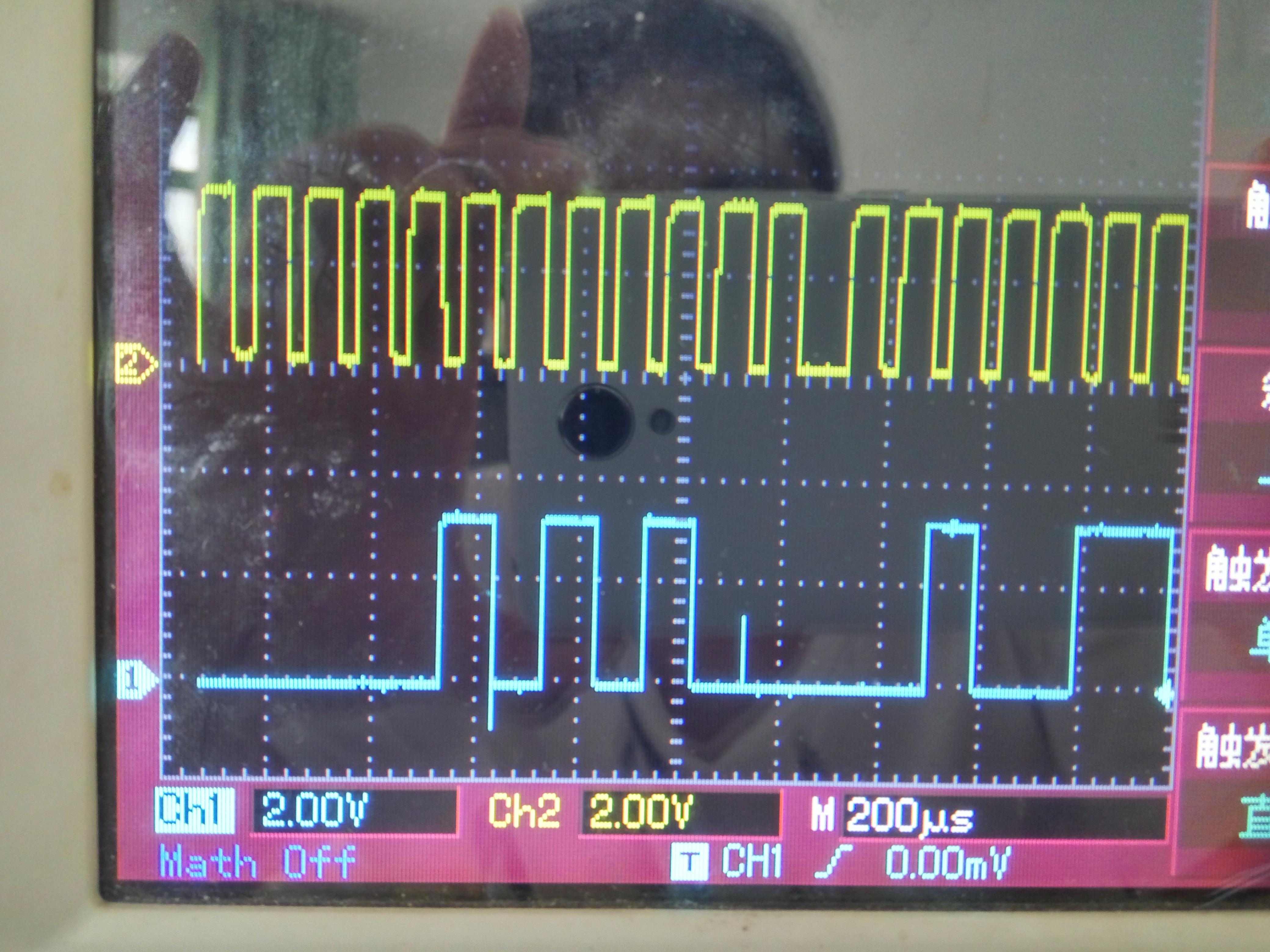

    I added a pull down resistor as your suggestion.And it is really works.But the problem still exists,and I got this
    It's not very clear but still can recognize that DOUT switched the Level at a rising edge.

    Great to know that the resistor helped. Is the output what you expect?
    I don't see the same issue in the first photo that you sent today. Could you try to capture it so that it is more visible (like the last photo you sent)?
    It is common to see small steps in DOUT as well as the other digital lines when capturing the data with a scope. If you are getting the correct data output, then do not worry about this. The spikes that occasionally happen are also common and are due to the internal architecture of the ADC. Do not be concerned about these either.

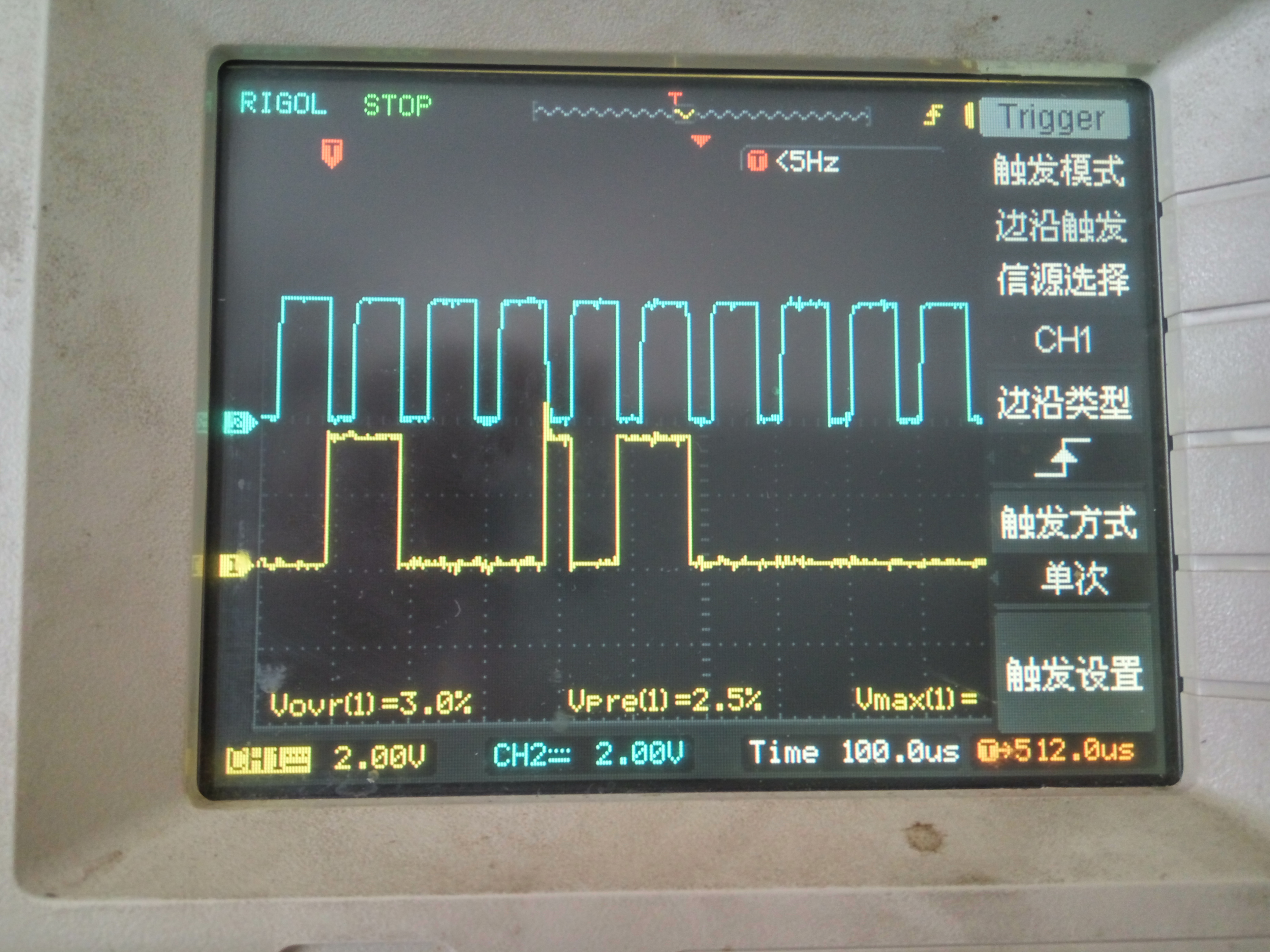

  • Here,the DOUT changed high at SCLK rising edge.
  • It's not easy to get this,I need to try many times.In fact,I only get 3 times of it in these days.
  • And anoher confuse is,although there is no pull down registor on DOUT,the level should keep right until the last SCLK falling edge.But it is not.
  • At most time,it's normal.But sometimes it's not,just like the photos I showed to you.

  • It seems like that the 16 bits of data have already moved out before the 16th falling edge is given to SCLK.This is illogical,but I can't find another explanation.
    It is possible that this is actually correct, but looks wrong because of the sampling rate of the oscilloscope. Can you try to get a close up photo of this happening? It is hard to truly determine if this is an issue without being able to clearly see the transitions in comparison to the SCLK.

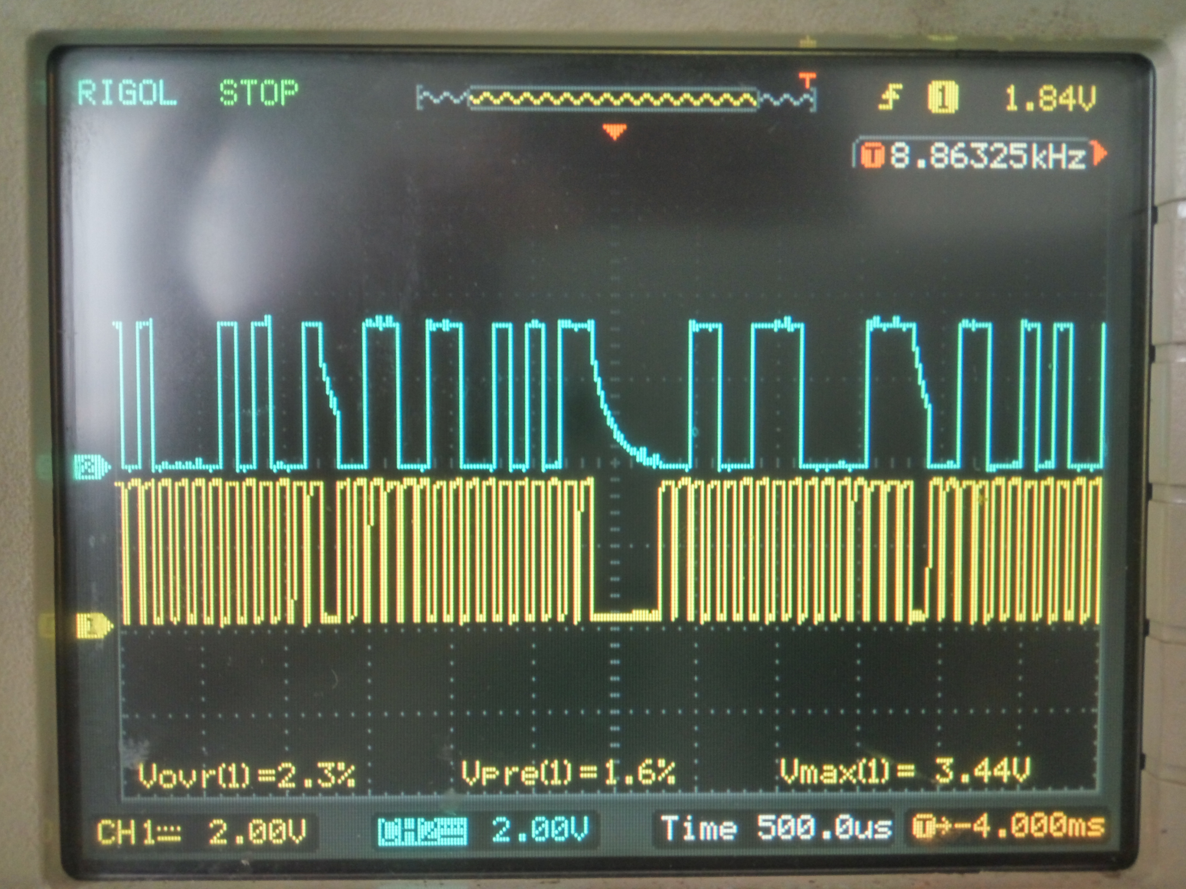

    This is the photo after I added a pull down resistor.It still happens that DOUT level changed at SCLK rising edge.
    This one for details

    Can you please try running two tests:
    1) Change the duty cycle of SCLK to 50%?
    2) Increase the speed of SCLK (it looks to be 10 MHz right now, so try the max of 16 MHz)?
