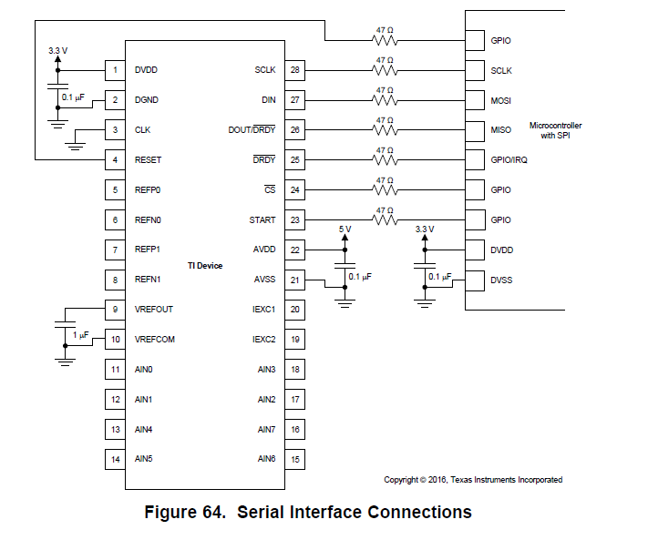

Hello all,
          I am working on this ADC with TMS320F28377D for SPI communication. I am having issue in code as after sending read data command and clock command, I am getting the value '0' in results but it should be having the value of the applied input. Data ready interrupt is coming and commands are transferred accordingly. In the inputs I am applying 2.3V on AIN0 pin and 1.65V(Vcm) on AIN1 pin. Please help me with the issue below is attached the code.

    I don't see anything specifically wrong in the code. Are you always getting 0 out or do you get some 0s and some data?
    If you consistently get 0s, I would verify my connections. Make sure START and /RESET are both high. I would also use an oscilloscope or logic analyzer to observe /CS, DIN, DOUT, and SCLK. It would also help to observe /DRDY to make sure the device is converting. If you are wiring connections back and forth from the device to the master, make sure there is a common ground. Post the oscilloscope outputs back here as well so that we can review them if data is coming out.
    With this code, I don't see what you have written to the configuration registers of the device. Have the calibration registers been written to? or have there been any calibration command run? It doesn't look like there has been a calibration which is fine for now. What are you using for the reference? Is the internal reference enabled? I'll need more information about the schematic and connections to the device as well.
    At this point, I'm not sure if this is a problem with the ADS1148 or with the microcontroller. If the problem is with the microcontoller, it might be best to post the question to the proper microcontroller forum as well.

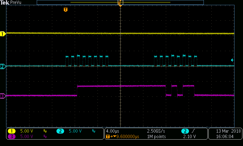

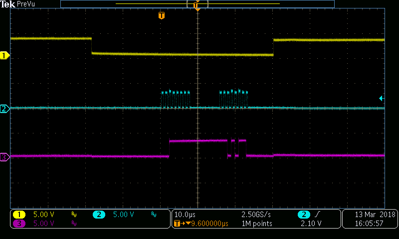

    After transmitting the last command '0' for clock i am just getting 0.
    Start and /Reset are high. /Drdy is converting the signal we are getting it on the oscilloscope as I am getting an external interrupt from /Drdy. The grounds are common of ADC and controller.
    No we are not using calibration registers because initially we just want to check data. I am taking internal reference writing in the MUX1=0x10h. Connections are done as per Figure 64. Serial Interface Connections, I am just leaving VREFOUT and VREFCOM open and AVDD is 3.3V.

  • Ami,
    The ADS1148 powers up in a state that starts automatically making a conversion. In this state, you would be able to clock out data with SCLK without having to do any kind of initialization. As long as you wait for a /DRDY, and clock out the data before the next /DRDY comes along, there shouldn't be any problems.
    I put together the most basic system I could to read out data from the device. Here's a small block diagram and a picture of the setup:
    I've connected START and /RESET high. There is a voltage divider that basically gives me 2V as the reference and 1V as the input. I've also connected the SPI communications to a Total Phase Aardvark so that I can read from the device. I apply the power, and check to see that the /DRDY is coming out at a 5SPS data rate (or a data period of 200ms). Even with a scope with lots of memory, it's difficult to see because the /DRDY pulses are so small compared to the full data period.
    Then I use the Total Phase Aardvark to read from the device. Here's the user interface from the SPI.
    I then send two bytes (16 SCLKs) to the device. Really, DIN is always low so it is the equivalent to sending 0000h. As I send in 16 SCLKs, I get 3FD6h (16342d). This is what you see from the oscilloscope:
    Or with a closer shot:
    If my reference resistor is a perfect 2.4kΩ then my input measurement would be:
    Measurement = 2.4kΩ * 16342 /(2^15) = 2.4kΩ * 0.4987 = 1.197kΩ
    Now, I'm not sure why you are not able to get something out of the device. If the /DRDY pulses are coming out as you say, then the device is converting (which means that both START and /RESET are both high). Here's how I would start with the debug:
    1. Make sure your master is really sending SCLKs and make sure that DOUT isn't doing anything.
    2. Verify all connections from the master to the device. Make sure there aren't any bad connections or bad solder joints through the SPI path.
    3. Look through all the commands that you send the device and verify the commands are the ones that you expect to send.
    4. Use the RDATA command to read the data. If you've accidentally (or on purpose) sent an SDATAC command, the output data doesn't come out unless you send the RDATA to read the data.
    Again, I don't know why data isn't coming out. I was able to throw this setup together and get data with a minimal setup and 16 SCLKs. There were no commands sent to the device. I will say that I did need some debugging with the input setup. I did have a bad connection and the input overranged to give me a 7FFFh output data. Regardless, it was not difficult to get the data.
