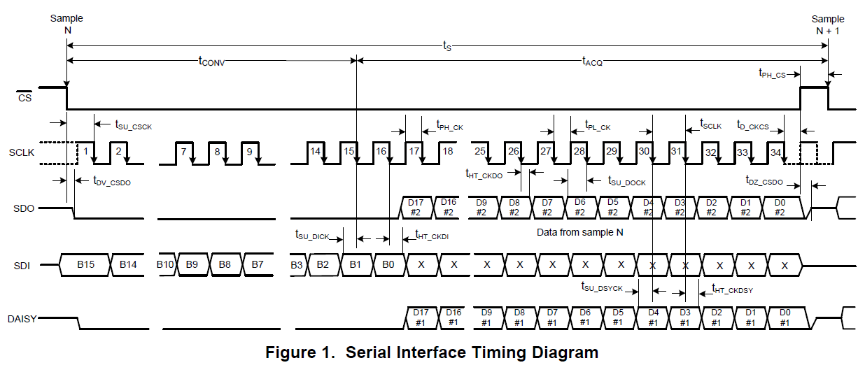

    If you can provide a scope shot of the digital communications, SCLK, SDI,SDO, CS we can double check your timing, this is a common source for communications issues.
    Note when the device is powered up, all its registers are in their default mode. I would suggest trying to read and write to the device registers to check your timing. If in manual mode, as Dale covered,  you will need to select a channel to measure. I would suggest looking at Table 9 of the datasheet to become more familiar with the registers of the device.
