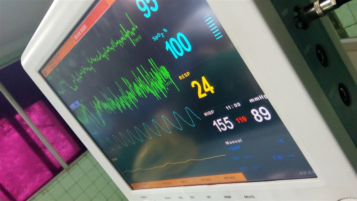

    At the time of Surgery/ during cauterization procedures, we are seeing only noises in the ECG waveforms using ADS1298R. These electro surgical noises should be removed to display the proper waveforms.
    Please guide us to remove this noise.

  • Hi ,
    Please find the attached video (or use below link -google drive)which will have the noise wavefrom at the time of using the cautrery machines.
    Some time lead off data received when the machine is using with patients.
    Please guide us to filter thease type of noise data. Please let me know if you have any clarifications in the video

  • Hi Vignesh,
    Thank you for providing the video!
    There are a couple things that could be going on here:
    Since I see the ECG waveform slowly appear after the cautery probe is used, the voltage from the cautery probe could be saturating the inputs of the ADC. Try decreasing your gain to 1 and see if the square waves on the ECG waveform still appear.
    Since you are using a lower sample rate, increase the RC filter capacitors by a factor of 100 to 4.7nF. This will bring the cutoff frequency to 1.5kHz which will help filter the noise.
    There are system level possibilities which will be harder to diagnose such as noise appearing on the power supplies, reference, or ground. I would recommend trying the two suggestions above first.

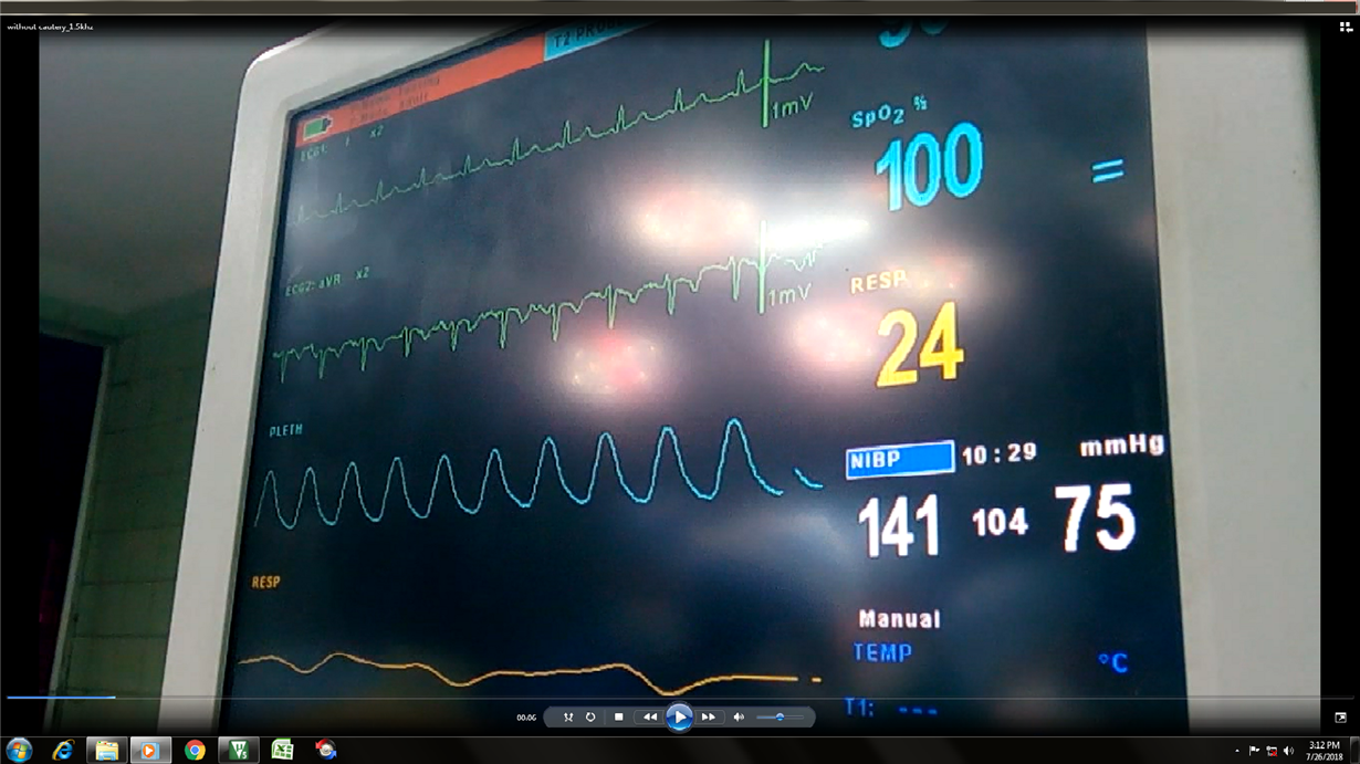

  • Hi Smith,
    Kindly find the attached images:
    1.Battery condition_1.5khz
    2.Power connected_1.5khz
      After changed 1.5Khz  frequency, normal condition(without using cautery) also get disturbed when power connected see the image but in battery condition the waveforms are looks like perfect.
    Before changed frequency , no problems were in power connected condition
    Thanks and regards
    Vignesh N

  • Hi smith,
     Hope you doing good.
     sorry for the delay in reply.
    We checked power connection, generally whenever try to connect power cord(2 pin L and N) ECG wave-forms are with noise.
    Normally in battery condition OR 3 pin power cord connected, ECG Wave-forms are looking good.
    BUT WHENEVER CAUTERY SURGICAL UNIT USED, TOTAL ECG WAVE-FORMS ARE COLLAPSED.
    Kindly suggest us to reduce cautery noise issue by using any internal filters
    Vignesh N
  • Hello Vignesh,
    I am doing well, thank you. I hope that you enjoyed your weekend.
    A 2 pin power cord is not grounded which explains why you are seeing noise.
    I have suggested in multiple posts that you probe your power supplies, reference, and grounds of the system to see if there is an unexpected source of noise during operation of the cautery device.
    Without additional information I am unable to help.
    At this point I do not believe that this is an internal filter issue with the ADC, but a system level issue related to your power supplies and grounding scheme.
