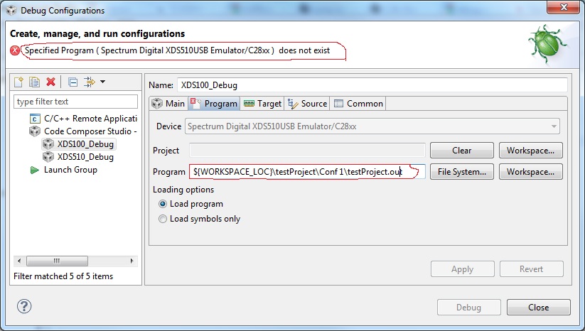

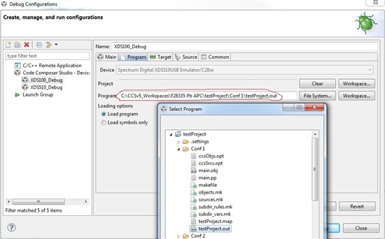

Does anyone know if it is possible to use relative paths instead of absolute paths when using the debug configuration to load a specific .out program ?
I tried using global variables but it seems to be unrecognised by this part of the program..
One workaround would be to be able to specify a specific build configuration while selecting the project to be loaded, but again, I could not find any way to do so..
I add some screenshots bellow to illustrate the problem:
The absolute path problem:
The miss of configuration selection while adding the file by selecting the project :

  • Lisa,
    I am currently using CCS v5.1.
    I am talking about loading the .out from the Debug file.
    In fact, my project includes several configurations, compiling with different options.
    I created several debug configurations, loading each time a different .out file, from each builded configuration.
    The problem is that when locating the .out in the debug configuration editor, I cannot use a relative path, only absolute path.
    The variable used was for example ${PROJECT_LOC}, or WORKSPACE_LOC, as bellow :
    ${WORKSPACE_LOC}\testProject\Conf 1\testProject.out
    I cannot understand why it wouldn't work..

  • Hi Pierre-Alexandre,
    try lower case ... workspace_loc since this is how it is defined in eclipse.
    In the mean time I am going to test a couple things here and get you feedback as soon as I am able.
    Lisa
  • Lisa,
    Thank you very much for your answer... using lower case solved the problem !
    I never thought of trying this..
    Thank you again,
    Pierre-Alexandre
