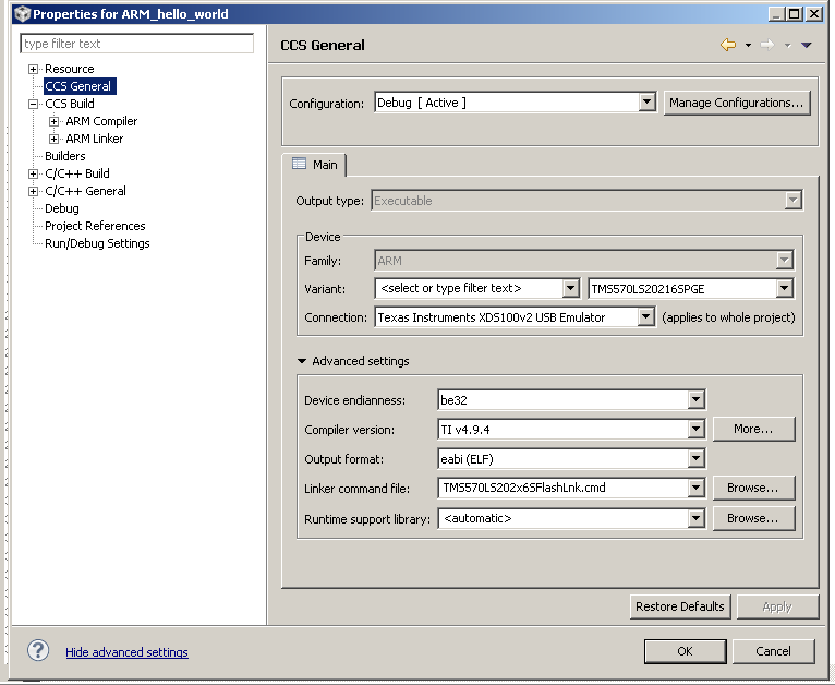

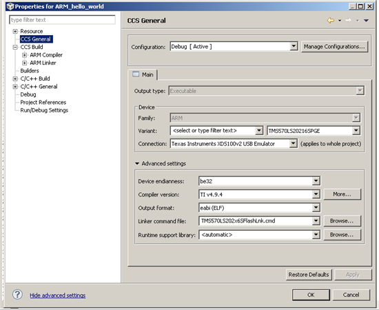

I attempted to create a "hello world" application for a TMS570LS20216 using CCS Version: 5.1.1.00031 with the following settings:
The resulting program didn't run - the main entry point was never reached.
On inspecting the
TMS470 Linker PC v4.9.4
>> Linked Sun May 13 19:57:21 2012
OUTPUT FILE NAME: <ARM_hello_world.out>
ENTRY POINT SYMBOL: "_c_int00" address: 00003b10

To get the program to run I had to add the following to the SECTIONS of the project TMS570LS202x6SFlashLnk.cmd:
.stack : {} > STACKS
.sysmem : {} > RAM
Should the C:\ti\ccsv5\ccs_base\arm\include\TMS570LS202x6SFlashLnk.cmd supplied with CCS 5.1 be updated to add the .stack and .sysmem sections generated by the compiler?
It also looks like the TMS570LS212xFlashLnk.cmd, TMS570LS213xFlashLnk.cmd and TMS570LS313xFlashLnk.cmd files have the same problem of missing sections.
