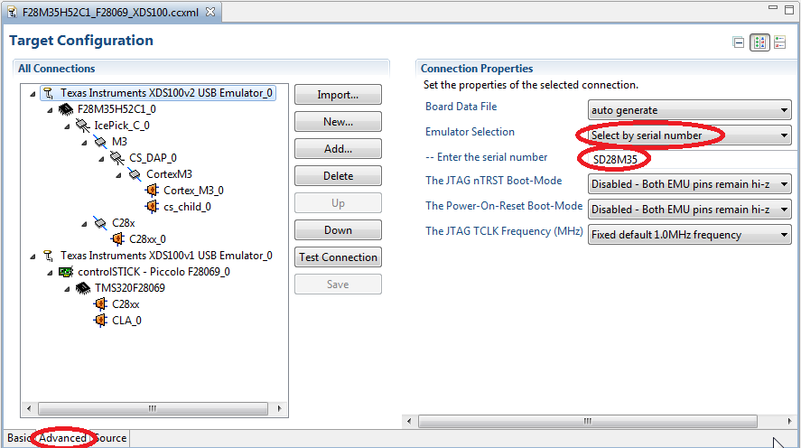

    Once you create the configuration, you need to make sure you get the serial numbers for each XDS100 emulator and then specify it in your target configuration as shown below:

    I have attached the target configuration file I created. You can drop it into your environment and use it. Just make sure you modify the fields for the serial numbers so that it has the numbers associated with your HW.

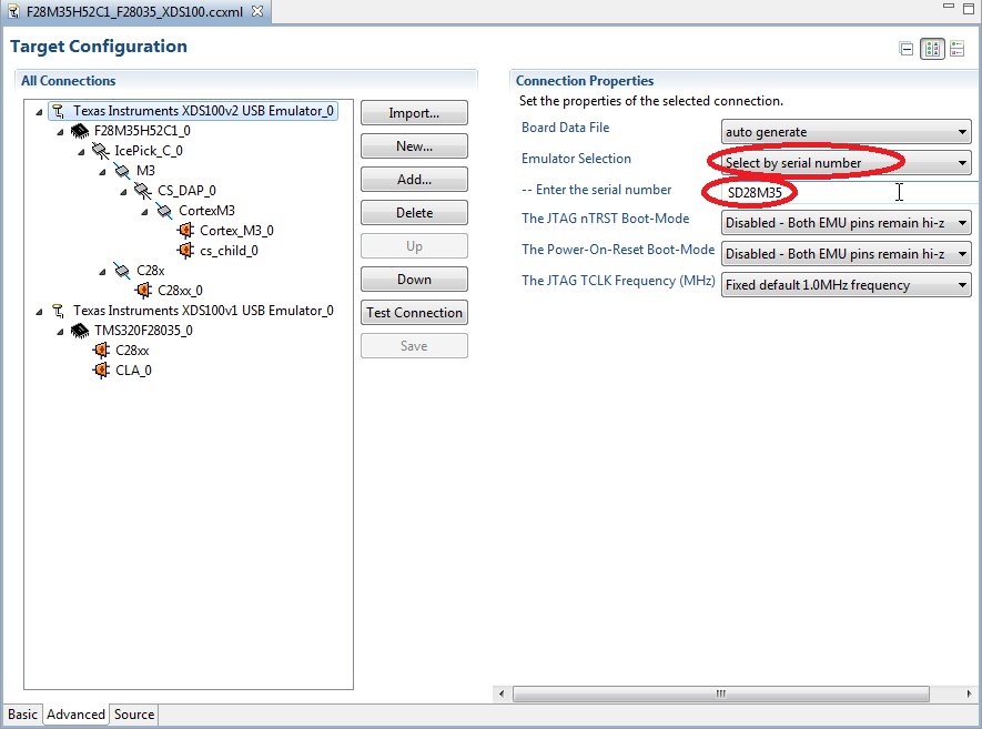

  • Hi Ki,
    Thanks for so rapid answer. I run your file configuration with my serial numbers: SD28DOCK for concerto and TIVHUIIA for Piccolo.
    VID/PID    Type            Serial #    Description
    0403/a6d0  XDS100v1/v2     TIVHUIIA    Texas Instruments XDS100+RS232 V1.0
    0403/a6d0  XDS100v1/v2                 Texas Instruments Inc.XDS100 Ver 2.0
    0403/a6d0  XDS100v1/v2     SD28DOCK    Texas Instruments XDS100+RS232 V1.0
    Piccolo is connecting, but concerto - not. I get error connection always:
     IcePick_C_0: Error connecting to the target: (Error -2131 @ 0x0) Unable to access device register. Reset the device, and retry the operation. If error persists, confirm configuration, power-cycle the board, and/or try more reliable JTAG settings (e.g. lower TCLK). (Emulation package 5.0.569.0)
    It seems that it is serial number problem , because the Concerto connect properly with EmulationSelection=OnlyOneZDS100Installed.
    Thanks, Sabina

    When you ran xds100serial, it detected THREE xds100 emulators.
    The first is the piccolo. The second is the XDS100v2 on the card itself (plugged in via mini-USB cable). The third is the XDS100v1 on the dock.
    You need to use the second one with your concerto. The issue is that the XDS100v2 on the concerto does not have a serial number. Sometimes they ship without a serial number. You can program it:
    http://processors.wiki.ti.com/index.php/Xds100#Q:_Can_I_change_the_serial_number_on_my_XDS100v2.3F
    When you used CCS with the concerto only, it worked since you didn't have to specify a serial number. With the multi-target setup, you have to pass in serial numbers and you passed in the serial number for the dock which will not work since it looks to be a v1.

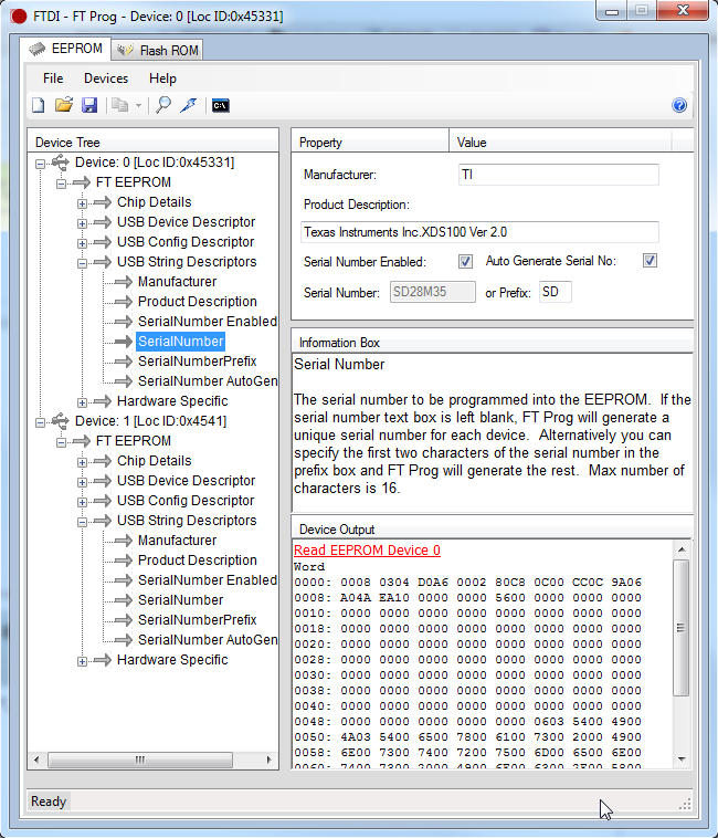

  • Hi Ki,
    Does TI provide FTDI MProg utility for changing Serial number? Could you send me link to it.
    Thanks,Sabina
  • You can obtain the utility from the main FTDI page:
    http://www.ftdichip.com/Support/Utilities.htm
    Search for 'Mprog'
    ki

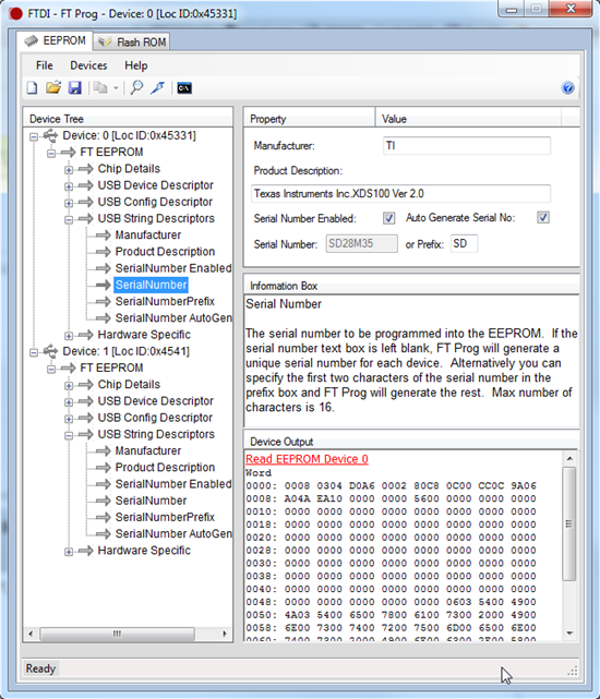

  • Hi Ki,
    Thanks for the link.
    Device->Scan give me :
    Number Of Blank Devices = 0
    Number Of Programmed Devices = 1
    But during Device->Program I get: "No device found' error".
    May be this device could not be reprogrammed?
    Thanks,Sabina
  • Try using FT_Prog. Looks like MProg is being deprecated in favor of FT_Prog. The interface is different but the interface is pretty east to use. Do a scan and you can find the devices and serial numbers.
  • Forgot to mention that FT_Prog is available on the same site as MProg
  • Thanks, I've programmed serial number for Concerto board and managed to connect both: Concerto and Piccolo. Now the problem is in the downloading program. downloading Concerto (M3 and C28) program and running work properly. But I can not download Piccolo program.
