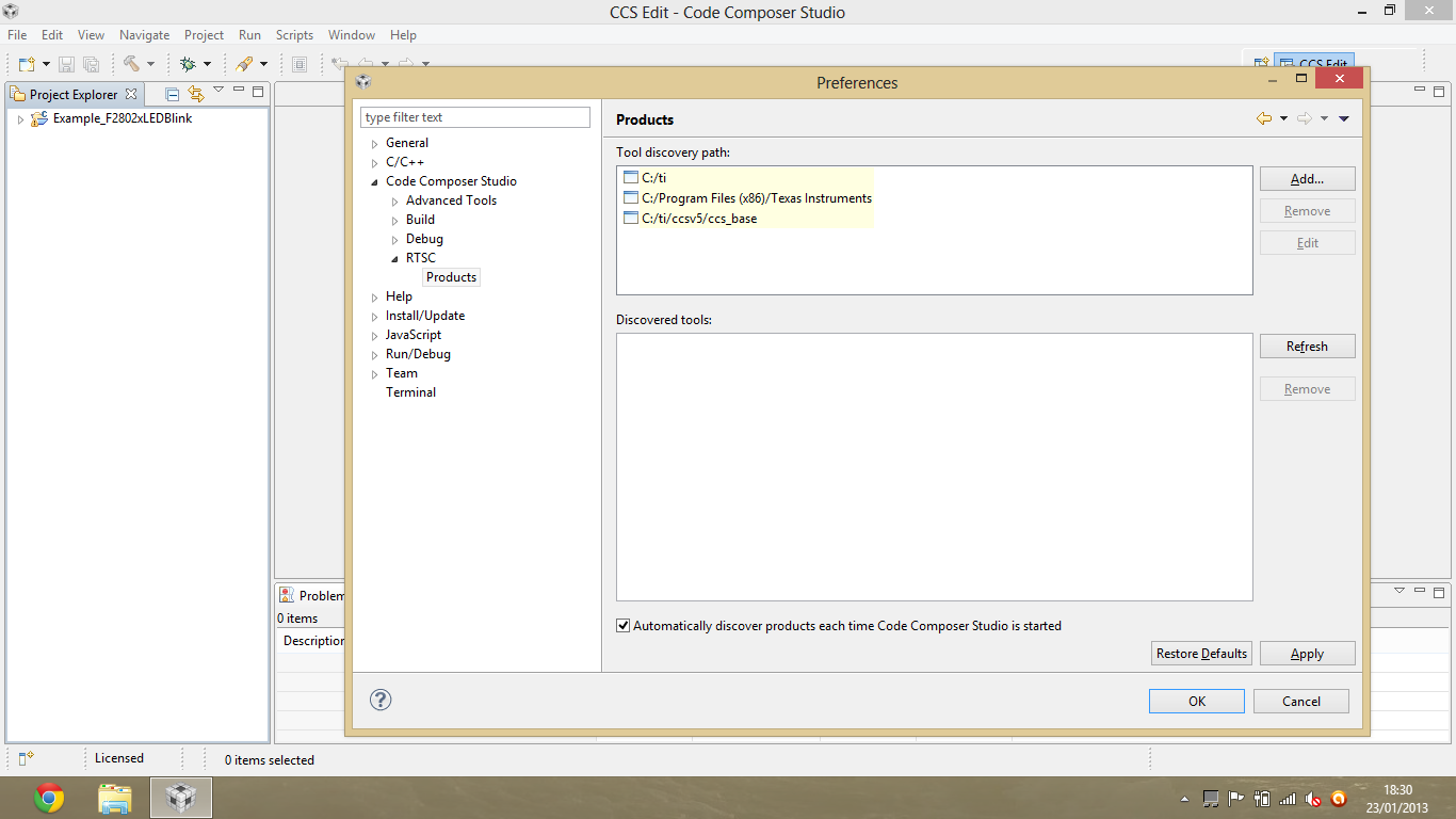

  • Hi Toby,
    could you please verify you have BIOS installed?  This is under Window->Preference->Code COmposer Studio->RTSC->Products.
    Do you see BIOS and XDC tools installed?  Could you send a screen capture?
    I suspect that either BIOS support is not there or the project is perhaps not configured properly.  Ie there are RTSC CCS projects and CCS projects ...
    Best REgards,
    Lisa

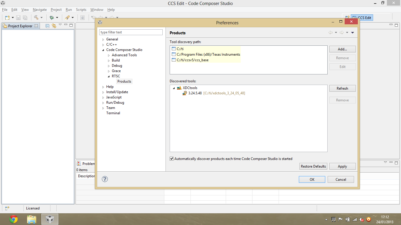

  • Hi Lisa
    BIOS and XDC tools do not appear to be listed in that window.
    I probably unchecked the BIOS install during CCS install as I dont usually use BIOS (AFAIK), but dont think I would have unchecked XDC.
    What is the best way of rectifying this? can I download and install these components individually?

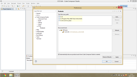

  • Hi Toby,
    where did you install the BIOS/XDC packages to? (ie what directory)  What shows in that RTSC->products tab now?  Do the packages appear there and if so, do they show any exclamation marks/warnings/problems?
    Lisa
  • Hi Lisa
    I let the installer put the package in the default directory (i.e. C:\ti\xdctools_3_24_05_48 )
    The xdc tools package appears in the products tab now under discovered tools, no warning marks etc and the install appeared to go OK.
