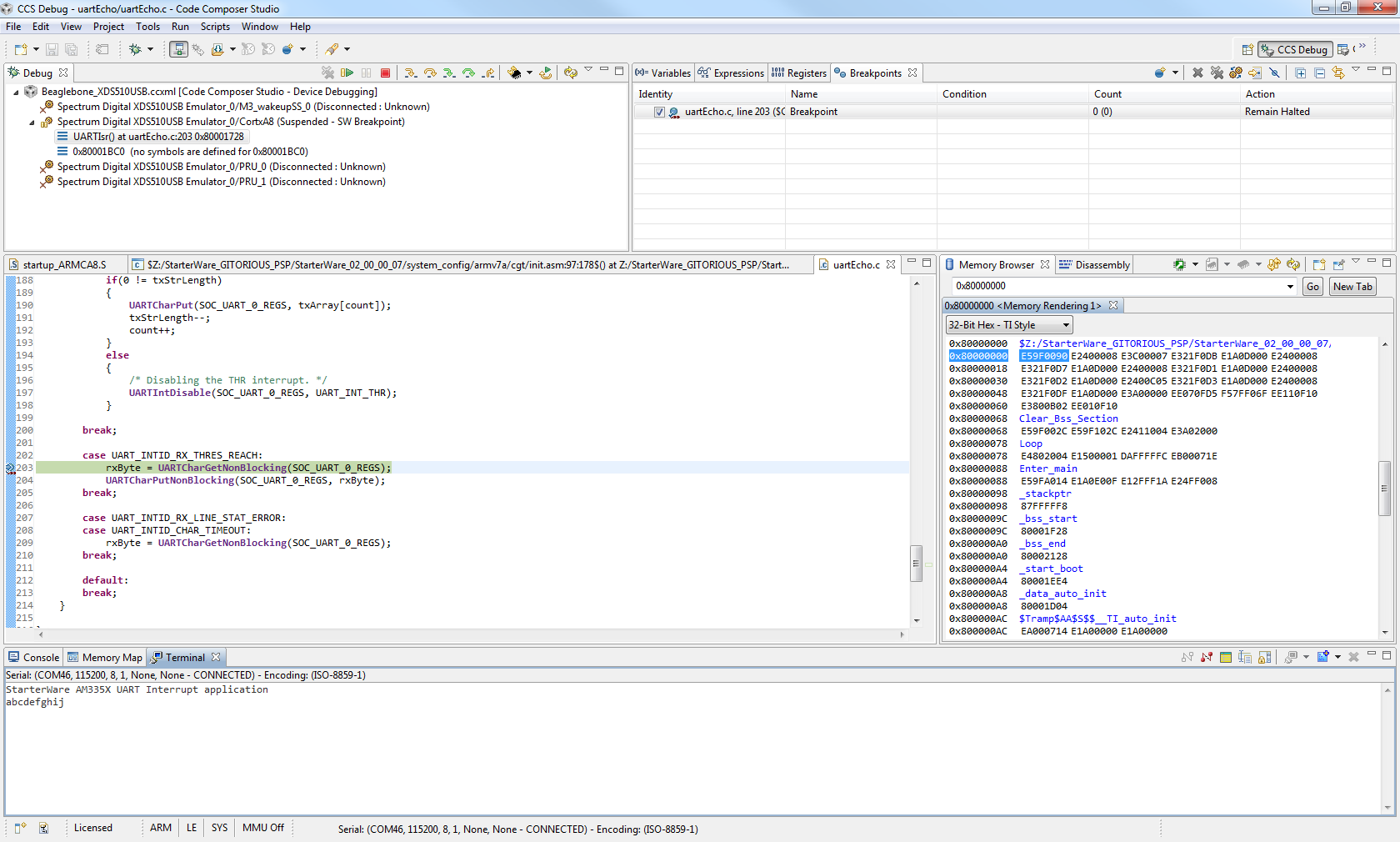

I applied a breakpoint in the line colored in blue. As soon as the breakpoint would be hit, I used to give a run. On a serial console application (Tera Term) running on the PC (host machine), I entered the characters a to z. I observed two different outputs:
  • When the Memory Browser window was open, I observed that the alternate alphabets only got displayed on the Tera Term. That is, the output was 'bdfhjlnprtvxz'.
  • When the Memory Browser window was closed, I observed the complete expected output, that is, a to z.
I require your help to explain this phenomenon. One of our customers observed something like this. I suspect that Data Acquisition process running in the background to update the Memory Browser window is consuming time because of which CCS is not able to manage the debugging. However I want your expert advice. Please revert if you need any more information.

  • Gurudutt,
    Unfortunately I couldn't verify this issue in CCSv5.3.0 or 5.4.0 on my BeagleBone with an external XDS510USB emulator and running the Starterware uartEcho example code. Please check the attached screen.
    Although at first glance it seems something related to the CCS and emulation combination, I suspect the issue may be somehow related to your system (a slower PC, the Teraterm software, the hardware board, the code). If you would like to explore this further, I suggest borrowing a spare emulator/board to rule out any possible hardware issues, use the Starterware code to rule out any code issues, use a different terminal program, or even clean out the workspace and the Debug configurations in CCS (rather unlikely to fix this, but it is worth trying) - for that last one, check the Troubleshooting CCS page at:
