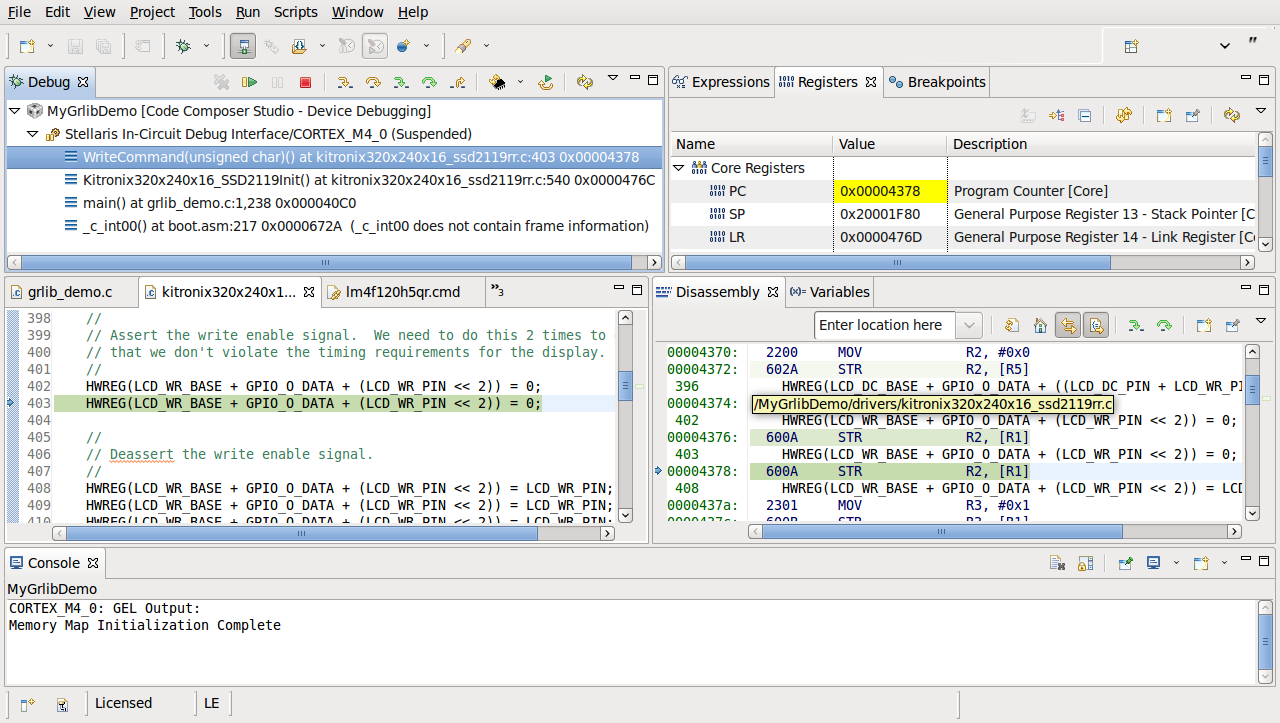

 I am porting examples from LM3S to get acquainted to LM4/TIVA, this migration is not pain free, I resolved the stack failure but this also suffer a so strange problem I am not able to address from where it come, deterministic execute first time but not the second one identical instruction, problem is repetitive to same assembly instruction forever.
 The driver module code execute right on SdCard example ported to this platform but not this reduced 2555.grlib_demo.zip.
All project is included here, this is from RDMIDK example, I cannot compile full version due to licence limit, after a while I identified where code lost control, assembly step over:
First STEP

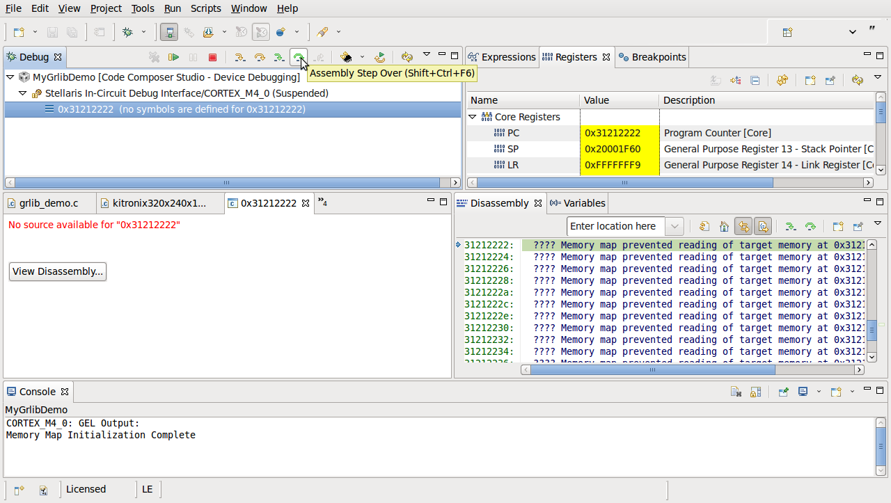

Next step crash.. Any idea why???

     Same code is working, I copied project from working sdcard example I pasted code there and I it work, I realized startup_ccs.c was missing, so I added to that project and now after the second instruction execute I see ISR FAULT is fired... Again why not after first write to?

    The screen shot shows the crash happening on one of the following lines:
    HWREG(LCD_WR_BASE + GPIO_O_DATA + (LCD_WR_PIN << 2)) = 0;
    The attached project has the CPU set to LM4F120H5QR, and LCD_WR_BASE is defined as:
    #define LCD_WR_BASE GPIO_PORTH_BASE
    The LM4F120H5QR only has 6 GIPO ports GPIOA to GPIOF. Therefore, won't the code fail when it tries to attempt to access the non-existent GPIOH on the  LM4F120H5QR?

    [/quote]From looking at the LM4F120H5QR datasheet by default write buffer usage is enabled within the Cortex-M4. This means that writing to a non-existent, or disabled peripheral, causes an Imprecise Data Bus Error which can allow the processor to continue executing some instructions before the bus error is raised.
    By setting the DISWBUF bit in the Auxiliary Control (ACTLR) write buffer usage within the Cortex-M4 is disabled and all bus faults are precise bus faults which means the faultISR should be entered after the instruction which writes to a non-existent or disabled peripheral, but performance is decreased because any store to memory must complete before the processor can execute the next instruction.
