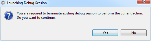

    Ok. First problem.
    Perhaps I am doing something wrong?
    Or perhaps I did not explain what I am trying to do.
    I need TWO SIMULTANEOUS debug sessions on two separate, but identical boards, USING TWO DIFFERENT EMULATORS (XDS560 and XDS100v2). The debug sessions need to access the same workspace so that code changes in one debug session are propagated into the other board/debug session.
    Is this possible? If so, can you give me some tips on how to accomplish this?

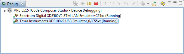

  • Aha!! Multi-Emulator Debug! Got it!
    Wow. So much easier!
    Thanks!

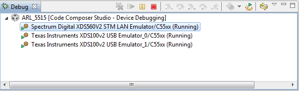

  • Ki-Soo,
    You have saved me HOURS of debug time!
    FYI, here's a debug session using ONE instance of CCSV5 with 3 emulators all running concurrently! Each emulator is running on a different (custom) board using the identical code base in my CCS project. Every time I make a code change it is automatically propagated to all 3 boards. I can now watch packets transmitted from board 1 to board 2, then from board 2 to board 3.
    Very cool!
  • Excellent. Nice to see you have such a multi-emulator setup working smoothly.
    For those who are interested, here is the wiki link Mike alluded to:
    http://processors.wiki.ti.com/index.php/Multi-Emulator_Debug_with_CCSv5
    A lot of TBDs in there, I hope to fill in some more content soon.
