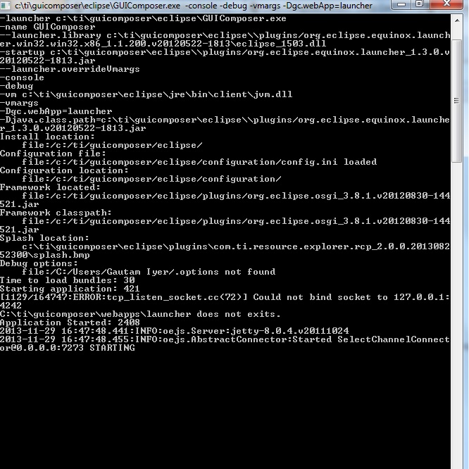

Recently started working with GUI Composer. It works all fine with CCS 5.5 but when I export the project and paste the same in guicomposer\webapps directory, GUI composer window opens with "gc.webApp not specified" error.
*NOTE: The sample modem_m3 GUI is working very well!
Attached is the screenshot  of the error window.
Gautam
  • Here's by using -debug in command prompt: Attached debug.log file.
    [1129/164157:ERROR:tcp_listen_socket.cc(72)] Could not bind socket to 127.0.0.1:4242

    c:\ti\guicomposer\eclipse\GUIComposer.exe -console -debug -vmargs -Dgc.webApp=launcher

  • Run the launcher itself, or pass in the name of the app for gc.webApp argument.
    Patrick
  • Hi Patrick,
    The launcher too gives the same error. Btw can you elaborate on the second suggestion "pass in the name of the app for gc.Webapp argument"?
    Gautam
  • If the app that you exported is named "abc", than you can run "guicomposer.exe -vmargs -Dgc.webApp=abc" in the command prompt.
    If the launcher gives the same error, can you attach the webapp here? I'll take a look at your app.

  • Hi Patrick,
    This worked out :)
    Thanks & Regards,
    Gautam
  • Glad that it works for you. Executing the launcher in the webapp folder by double clicking it in file explorer or running it in the command prompt shouldn't required to pass any arguments. The launcher is just an executable that execute guicomposer.exe with the arguments for you.
    It is 10 after 12am here :)
    Patrick
  • Patric, I guess the file name mattered too here. When I replaced spaces with underscore(_); it started detecting and now the .exe file work well.
