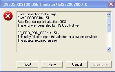

So I tried to make the process of debug the CCSv3.3 , and the results were also unsatisfactory . When I try to connect then the following error appears :
Error connecting to the target :
Error 0x80000240/-151
Fatal Error during : Initialization , OCS ,
This error was generated by TI's USCIF driver .
