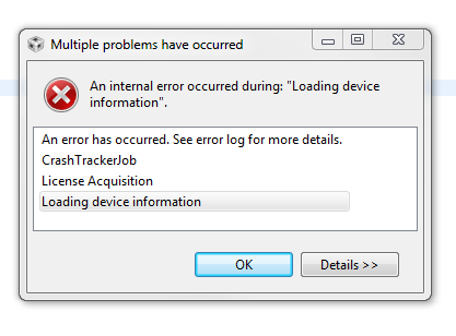

    Here is some more detail about the issues I am having.
    1)      When I start CCSv6 I get the following message
    2)      When I try to build a project I get this error
    3)      When I hit debug I get the following

  • Omar,
    Sounds like it is having trouble reading the device description files.  For MSP430 there should be a lot of devices listed other than Custom MSP430.
    Installing Java won't help as CCS ships with its own JVM that it uses to ensure compatibility.  It does seem like something is fundamentally wrong with the install though that is causing it to have issues when it tries to access files from disk.
    If you look in /ccsv6/ccs_base/common/targetdb/devices are there a bunch of msp430 xml files in there?
    John
