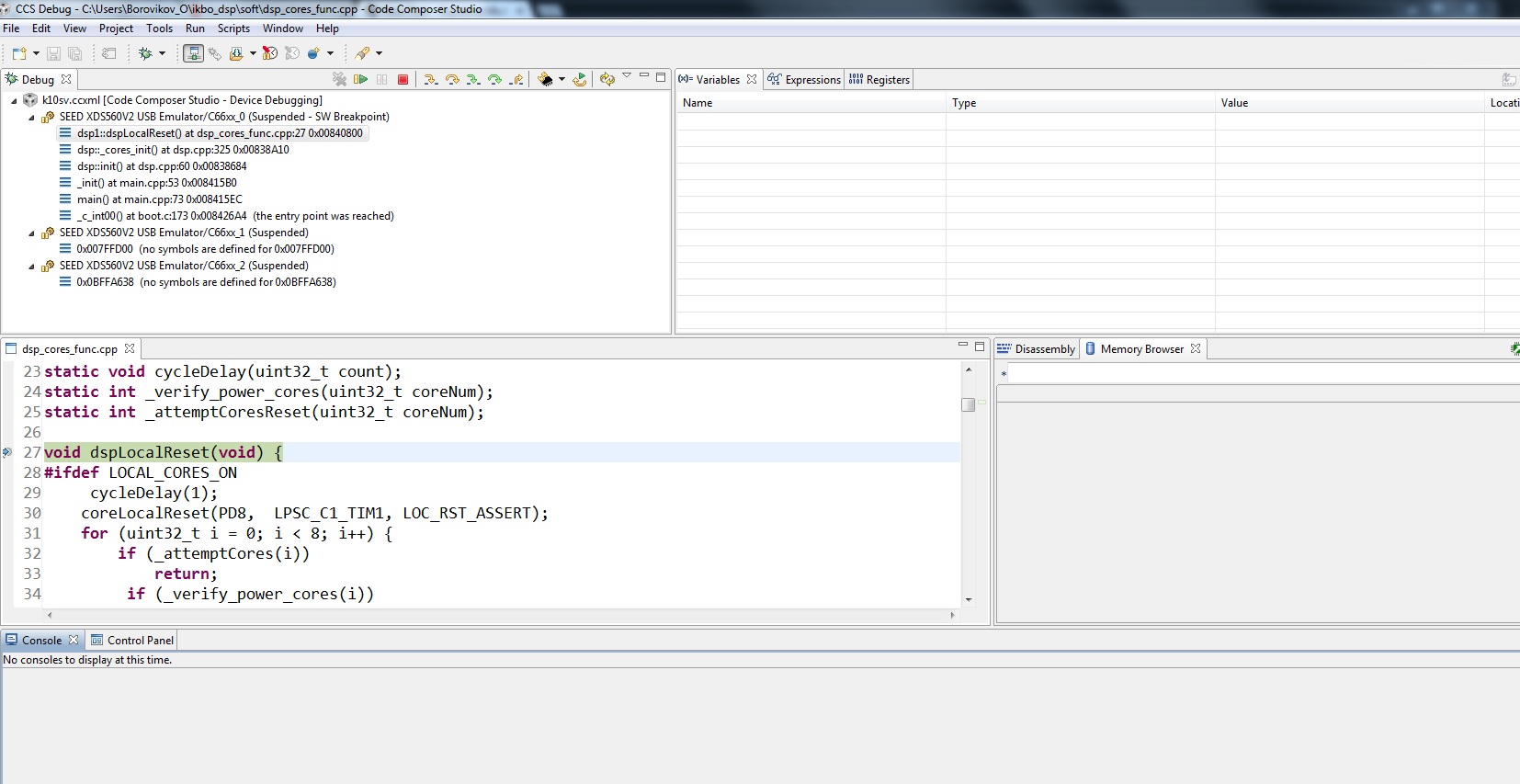

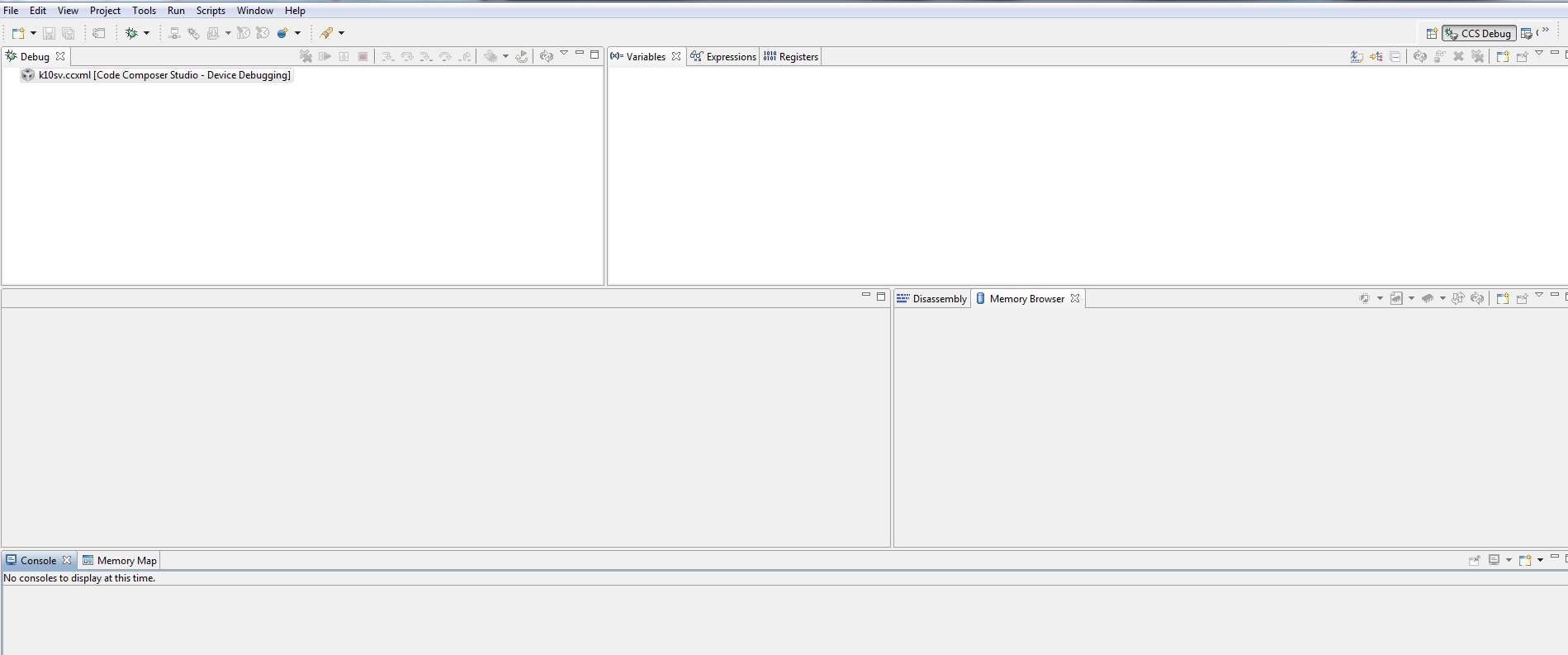

If I run my script via Scripting Console without preliminary start my project I have this

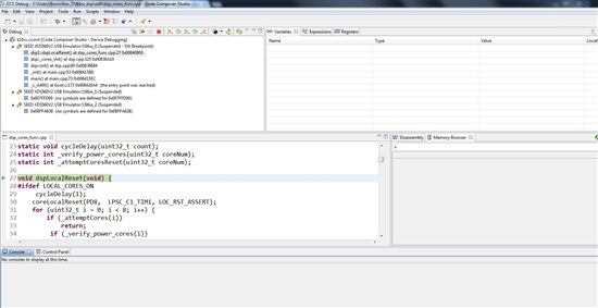

If I run my script after run my project (and after unloading project from CCS) I have this
(it's right work)

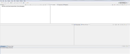

If I run my script without CCS I have this
C:\Users\Borovikov_O\ikbo_dsp\app\debug>c:\ti\ccsv5\ccs_base\scripting\bin\dss -dss.debug DebugServer01.js
Loaded FPGA Image: C:\ti\ccsv5\ccs_base\common\uscif\dtc_top.jbc
Exit from dss  is going on here
      debugSession1.target.run();
It's don't work -  catch(ex)

    If I run my script step-by-step I have next result:
    last successful command to my script is
    print(dsp_setup_str);
    next command is crash:
    // Run the program
    try {
    } catch(ex) {
    quit();
    I am  crash in to string
    catch(ex)  - don't work
      Oleg
