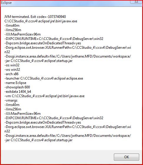

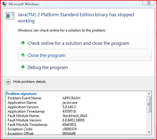

CCS4 crashes when clicking "Terminate All" to end debug session.
When I click the "Terminate All" during a debug session CCS 4.1.1.00014 crashes. I don't see any files in the <INSTALL DIR>\ccsv4\DebugServer\win32\components\Logs folder but I do see a "log.0000000001" file in the <INSTALL DIR>\ccsv4\emulation\analysis\bin. Any help would be appreciated.

  • These are the basic things that I have done:
    1. Build an application.
    2. Start the debugger by pressing the "Debug" button -- this opens up the debug view.
    3. Once the app is loaded into the device, I press the "Run" button to start the debug process.
    4. I can press the "Halt" button and "Run" buttons repeatedly without issue.
    5. Everytime I press the "Terminate All" button the app crashes and closes.
    Those are the only debug actions that I have performed with CCS4.

  • Jim,
    Can you rename the file ccsv4/emulation/analysis/bin/ctools.dll to something else and let me know if the crash goes away.  Removing that file will prevent hardware breakpoints from working, so this isn't really a fix, but it should confirm if that file is the cause of the crash as it looks like it might be in the logs you sent us.
    Darian
  • Darian,
    I renamed the ctools.dll file and can now terminate a debug session without crashing. It does appear that the ctools.dll file is the culprit.
    Jim

  • I'm also having this trouble. I'm using windows 7 ultimate 32bit and C6713 DSK.
    So it means if I rename that dynamic library ctool.dll, all the hardware breakpoints will be out of operation?
    Hope this be fixed soon.~

  • Hi John,
    I test the zipped dll and no change about the problem.
    The error and the log is attached.
    Regards.

  • Good news for now.
    I test the dll with two-three step debug and no error or crash is seen when i click the terminal all button.
    If I see any errors during the deep programming and debug process, i will write again.
    Logs are attached.
    Thanks.
    (I also test it with CCS Version: 4.1.3.00038.  and i experience connection problems to the emulator. I can not connect to the XDS100 and CCS is locked. )
